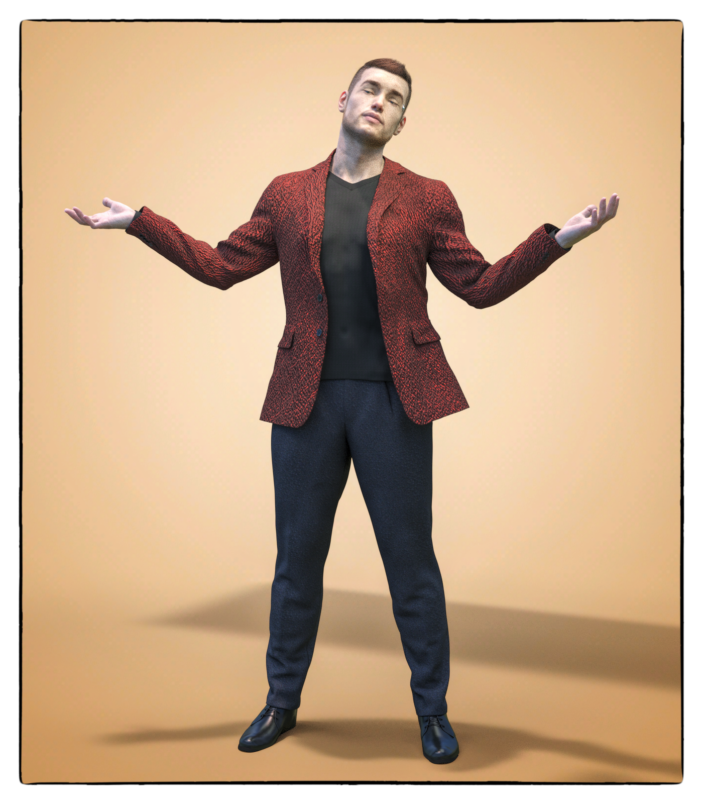

    Okay, I've messed around with the suit and I'll be quite honest- I rather lke it. Its a nice male casual basic, and goodness knows we need more. It is shader friendly too which is nice.
    Downside is the texture presets for the jacket dont work.... I'll have to put an order in for that at some point.
    Ir all dforces well though!

    He looks so different in clothes surprise
    I think his forearms look quite thin kinda wonder what’s going on there will check it out later. For having two layers of cloth his arms should be less narrow.
  • The arms do look odd. Maybe because i zoomed in to see the material
