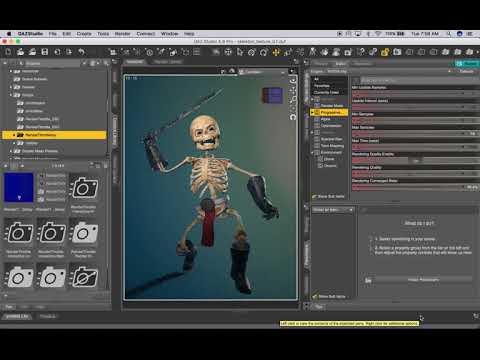

    I did some beta testing for this, I like it a lot. I don't have a machine really capable of posing in real time, but the easy icon to click on and off instead of using the dropdown make me use interactive a lot more when doing light tests and light positioning. I mean I can pose with interactive renderlo and interactive med, but it's a lot snappeir to use the flat shaded for me. I use the interactive more for fine tuning, making sure hands are gripping the gun, finger on trigger, hand touching arm, lights, that kind of thing.
    If it's installed correctly, what you are looking for should be in my library > scripts > renderthrottleiray
    It should be called !RenderThrottleIray Install Actions
    Once you use that, you will get all the presets right in the toolbar, next to the regular old render button.
    You can hover over each of the new camera icons and a text will pop up telling you what it does. The black cameras icons are interactive modes, the white camera icons are the full render modes, and the last camera with a line though it, turns off the interactive render, and sets viewport back to what it was set at before.

    A few weeks ago I was working on a scene with many figures, thought that I had everything sorted and left it to render for a couple of hours...only to find a mistake  that I had to then fix with spot render and Photoshop.
    Since then, I have had Render Throttle in my wishlist and have debated whether to buy it many times.  Today, after watching the video on the store page for the third time, I decided to buy it and give it a go.  I thought that I'd post my experiences with this so far in the hope that they might help anyone else who has also been debating whether to try Render Throttle:
    I always install from .zip files and move them to the content directory.  Render Throttle installed fine, but when I clicked the Render Throttle Install Actions button, I only got text buttons on the toolbar.  I found that the problem was with a folder named DAZ Studio_4.5 which contains the icons - my DS folder is named Daz Studio 4_9 so I had to move the icons there and then re-run the script.  This could be my own fault if I renamed the DS folder - I can't remember.  If so, then nothing that the vendor can do about that, but something to watch out for.
    After that initial hiccup I loaded up DS again, added an 8K HDRI background and hit the Interactive Lo preset.  It took about 2.5 seconds to initialise and I now had an interactive iray viewport.
    Changing to Interactive Medium too about 2 seconds, after which again there was a smooth interactive viewport.  Going from Interactive Medium to Interactive High took less than a second and although a slight lag was noticable on moving around, the viewport was more than acceptable.
    After this I tried adding a figure and clothing.  The Interactive High can get a little laggy at this point on moving, but renders again extremely quickly.  On posing the figure there was more than acceptable performance.
    Finally, I decided to push things a little and loaded a set of armour on to the figure with lots of reflections.  At this point the Medium and High Interactive renderers became very laggy, but the Lo Interactive was fine.
    In terms of hardware, it seems that the Lo Interactive is GPU intensive when you are moving/rotating the viewpoint in a scene.  Posing a figure brings the CPU in a lot more.  The Medium and High Interactive are very CPU intensive when moving in a scene.  My CPU is not a particularly fast clock speed any more, but moving in Interactive High or Medium does appear to use all cores.  As soon as you stop altering a scene, the GPU kicks in and gives a reasonable clear image very quickly.
    I should also state that my normal working viewport is around 958x716 pixels.  Making this smaller obviously improves performance.
    The three render presets are fine - I'll probably still use my own, but the included ones give more thna acceptable results in good time.
    Overall, I am extremely pleased and impressed with Render Throttle.  I think that my workflow will probably start in texture shaded mode for adding figures and posing, then go to Lo Interactive with some switching to Medium and High settings to check the scene.
