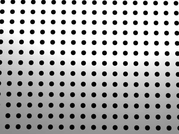

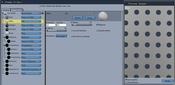

    The TILE shader actually makes nice round holes if you fiddle with the mortar and radius settings.
    640 x 480 - 102K
    1045 x 509 - 154K
    Post edited by wetcircuit on

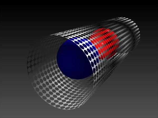

    Yup, what Holly wrote, but she is so fast and I am slow. :)
    This is using Holly's technique with a grid in modeler and a bend modifier to 360 degree bend.
    640 x 480 - 29K

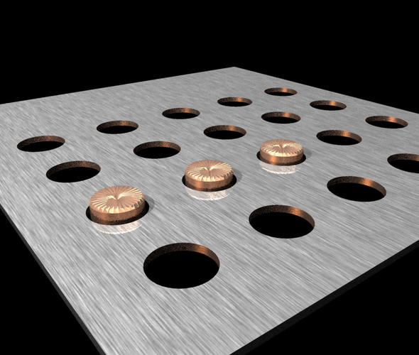

    Assuming your metal needs some thickness like most metal I've seen.... :)
    You might want to consider making an array of cylinders whose diameter is the same as the size of the holes you want...then Boolean them with the metal sheet. This is one of the very few times I'd opt for using booleans in modelling. It will give you a horrendously bad looking mesh after the boolean, but IF this is a rigid metal sheet that won't be deforming at all, you can do a very quick boolean, do a nice clean UV map, and get what you need really quickly and cleanly.
    Personally I'd develop the metal sheet and array of cylinders, and do the boolean, all in Hex, then import to Carrara. Though there may be a nice way to do the modelling in Carrara, but I hate Carrara's modeller so I'm allergic to using it.... :)
    Here's an image of a hunk of metal made in Hex. I also installed three chromular framises in the holes. Inside the holes is a separate shading domain.
    1000 x 847 - 171K
    Post edited by JoeMamma2000 on

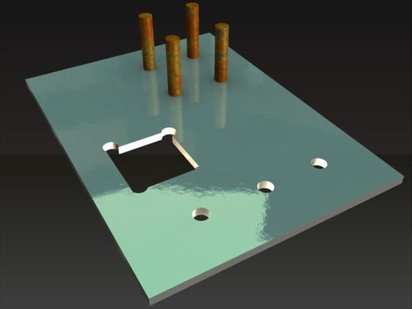

    Boolean can be done in the assembly room of Carrara. It's a much improved version over the old Boolean in the Model room.
    Just need two objects and the Boolean operator is under the Edit menu (towards the bottom).
    800 x 600 - 22K
