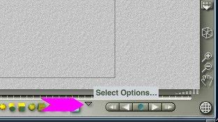

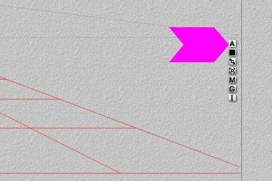

    I'm not sure I get you right. You select an object by clicking on it in the wire frame. If there are more than one object at the same space, hold down the ctrl key. At the bottom, there are the thumbnails of the objects, which you can click on and get a list from which to select. And then, there is at bottom right next to the families the mesh and group selector - and of course, the families.

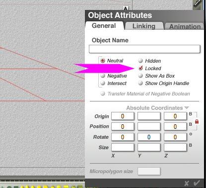

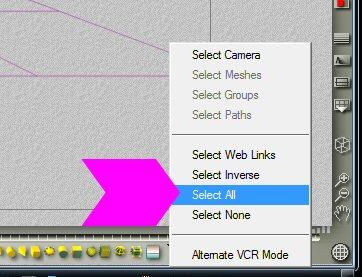

    Might also be that some of the objects are locked for some reason, so what you can do is use select all and uncheck the radio button which controlled locking in the Object Attributes.

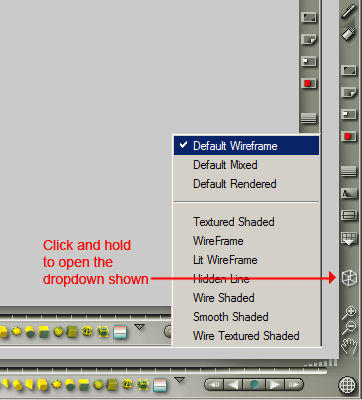

    @fs.ursem - you might also have another display mode than Wireframe selected. If so, change it as shown.
