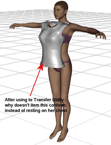

    As i said in above post, got no painting program on my 64bit partion, so goen into daz 3 on my 32bit for screen shot so you can get my jest of what i am on about,
    when you go through the transfer utility click accept this is the end result, the clothing item sits on her chest, yes if you move genesis figure the clothing follows, but why isn't she wearing the clothing!!!!
    Just spotted the spelling mistake in the picture.[ replace to with the]

    I don't make clothing, so I can't help much. When modelling clothing for Genesis, you are supposed to use the BASE Genesis figure, and not the basic female.
    Are you using the bridge from DS to Hexagon, and sending the Genesis figure over that way to model your clothing on, and then sending the clothing back? Does the clothing fit the Genesis figure when you bring it back into DS? If you load the base Genesis figure, and send that to Hexagon, model your clothing around it, it should work. It looks like you may have moved the figure from it's zero position.
    The figure above is V4, not Genesis.
  • Richard HaseltineRichard Haseltine Posts: 111,313
    The Transfer Utility works with weight-mapped figures only - have you converted V4 to a weight mapped figure?
    The OP was using Genesis on his DS4.6 on 64 bit setup, but the current image was taken in DS3, 32 bit just to show what the problem was. Not very satisfactory, but it illustrates what he means.
    The clothing figure comes out like shown when he uses Genesis.
    Clothing for any figure, esp for Genesis, "must" be in exactly the correct loading spot to "land on" Genesis when "imported" into D/S and Genesis is "as is when and where loads".
    Then one uses the transfer utility.
    Then one saves the clothing and deletes what was just loaded.
    Then one opens the new saved clothing file and carries on.
