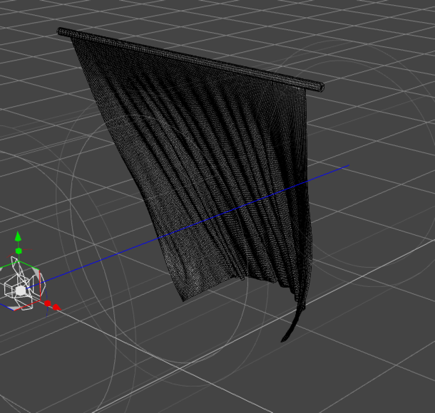

    Tried both selecting top geometry of the curtain and setting it to 0 dynamic strength, and also adding a cylinder "rod" and parenting the curtain to it. Neither has prevented the curtain from dropping toward the ground. Any thoughts?

    Here are Start and Finish images. You can see the "rod" I added and parented the curtain to.

  • Just [parenting won't help - having the rod, with a fair number of divisions, overlap the top of the curtain may. How did you assign the zero dynamic strength?
  • DekeDeke Posts: 1,636
    I created the rod as a cylinder. Then in the simulation setting panel: hamburger menu....dforce..."static surface." And then in surfaces panel....simulation...Dynamic Strength, settig that to 0.

  • Deke said:
    How is the curtain element linked to the curtain if not by parenting?
    I connected mine by having it physically overlap at the top of the curtain. This traps the curtain in place where the mesh intersects.
    Tried that but it doesn't work.  HAve the cylinder piercing the fabric of the currtain.  Set the curtain to Gravity of 2.   Now it doesn't move at all.  Any chance you can give me a step by step of how you set up your file?
  • My test scene was very simple. The curtain is a plane primitive, 2 meters on a side, with 200 divisions, rotated into a vertical position. The rod is a primitive cylinder, 2.2 meters long, 5 centimeters in diameter, with 220 segments and 12 sides. It's positioned so the axis of the cylinder is more-or-less at the top edge of the curtain. The only other thing in the scene is the dForce wind node.
