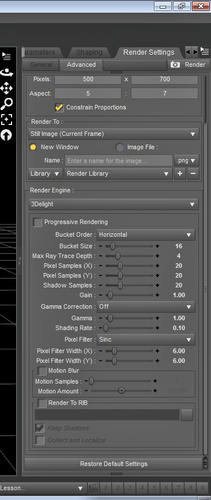

Are these render settings ok for DS4.6 ??
Muon QuarkMuon Quark Posts: 596
edited May 2013 in The Commons
Just wanted to check that these render settings are ok.
Thanks.

  • frank0314frank0314 Posts: 15,116
    Yep, you should get nice results with those

    I might use higher raytrace depth on a render with lots of water or reflectivity. I'm willing to be corrected on that point, though.

    It depends on objects, that would work fine for water and basic reflections, but a glass with 4 sides (two outer two inner) would need higher. I adjust mine depending on items used 8 or 16 sometimes.

    It's mostly fine. Cut down the Pixel Samples X and Y from 20 (!) to 4. 20 is good if you do Depth of Field renders, but it will slow down and make unnecessary computations for any other render. Although usually 12 is enough even for DoF.

    Max Ray Trace Depth works for reflection like this 0 no reflections, 1 one reflection, 2 two reflections like a reflection of a reflection and so on.
    0 will give you Ray Traced shadows but if you are wanting light to penatrate a surface that has ray traced functions like Refraction then Jaderail is on the right track. You really only need to match the Max Ray Trace Depth number to the amount of surfaces the light has to pass through. So we know for Ray Tarced shadows 0 is fine but if you have 4 surfaces of an empty glass then a value of 4 will be good for the Max Ray Trace depth. Increasing this number will increase renders times so keeping it down is a good idea and should be adjusted for each scene.
