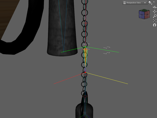

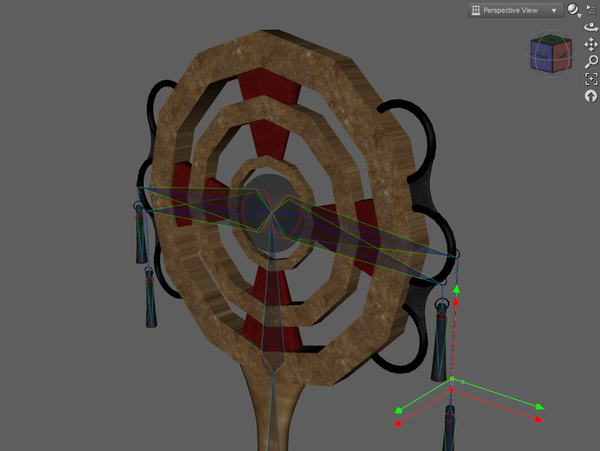

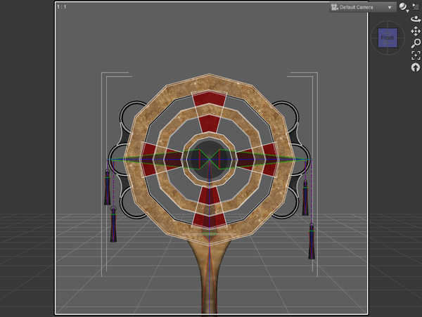

    This is the prop I'm playing with. The chains on the side of the headpiece are going to be "bendy" instead of their now rigid state. I want them to point at the ground when the staff is horizontal, or swinging around when the staff is "in motion".
    I have also added bones to the staff in case I want to "break" it over someone's head or have it chopped apart by a sword. But for now, the focus is on the chains and dangles.
    Each bone is about 5 chain links long (somebody told me that making bones for each link is unnecessarily excessive).
    So I'm thinking the "dangles" (at the end of the chains) are rigid, but the chain itself is bendy.

    What you might do is select each link in turn for each bone, starting with the oen that lines up with the origin, and fill with increasing weights (so if there are five links per bone fill with .2, .4, .6, .8 and 1) - select connected should work for each link, just seelct one polygon on the link then use the command.
    The idea of having bones to break the staff won't work unless the mesh is separate - assuming you wish to split it and not just bend - as when you move one bend the joining polygons will simply be stretched out..
