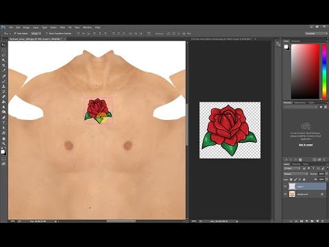

    you could use a paint program Make a copy of the original texture and blend it in using layers. Would save on memory as well as looking more natual

    Usin paint program on the other hand might not be so easy option if main texture uses tiling for example brick wall.

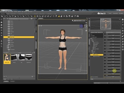

    There are a couple of products in the store that might make using decals easier, like this one. I actually bought it, but I never really used it. You can use custom decals with it, and it includes some in depth tutorials. https://www.daz3d.com/iray-decal-kit

    Also worth mentioning that Kindred Arts is super helpful with questions.
