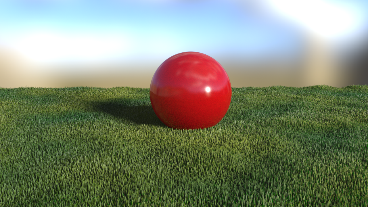

    Sorry for spreading disinformation:( You can actually use the AoA shaders along with aweSurface if you use the DS standard lights or AoA lights to illuminate them. In this test the sphere is using aweSurface. It's illuminated by the default ruins HDRI. The AoA grass plane is illuminated by an AoA distant light and AoA ambient light. The AoA lights are flagged to illuminate only the grass. So this opens up a bunch of possibilities. I could for example use the HDRI only as a backdrop and use only standard lights. I found out this when thinking how to set up the 3DL scene of the Medieval Lands now that I got a 3DL ground plane (which is a shadow mixer network). Tks again @AndreyPestryakov! Yeah, have to experiment...
    Sidenote: This renders very fast:)

    ..thanks.  Yeah, I love that shader (which is displacement based).  Odd it doesn't' work in anything but the default or AoA lights. I've had it work in UE, but then render times bloat as well.

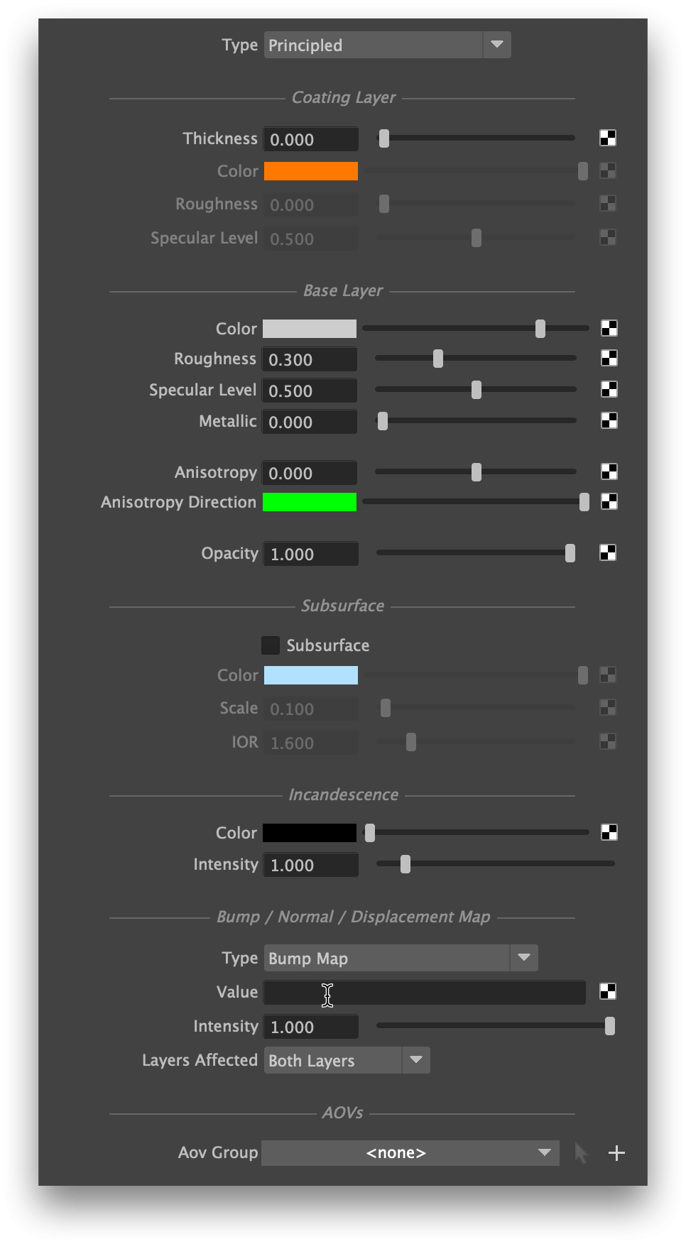

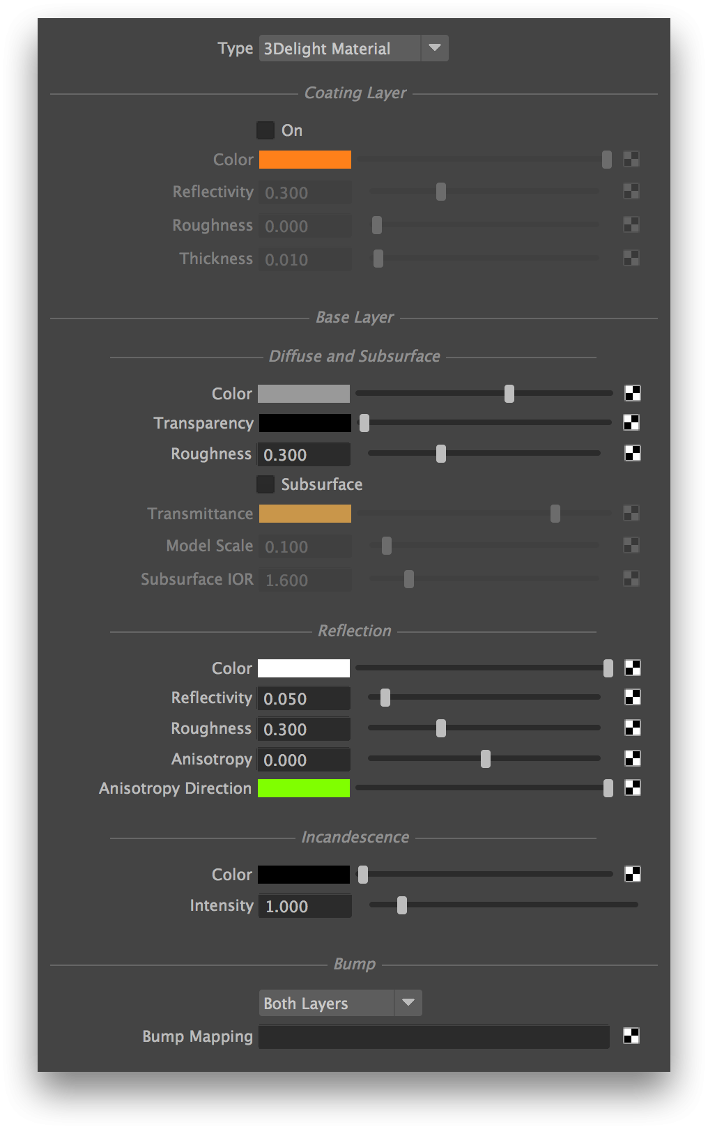

    Don't believe me? Here's what you'll see with 3delight NSI in Maya.
    https://documentation.3delightcloud.com/display/3DFM9/3Delight+Material
    https://www.3delight.com/documentation/display/3DFM9/3Delight+Principled
