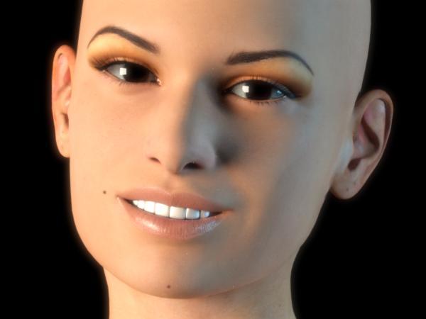

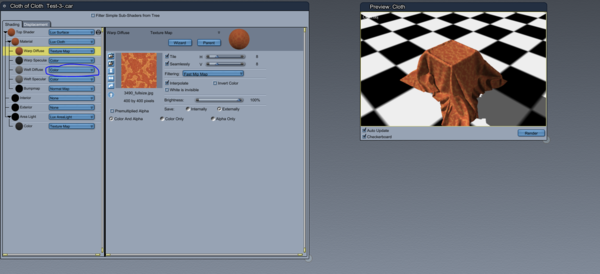

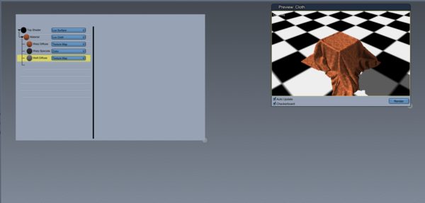

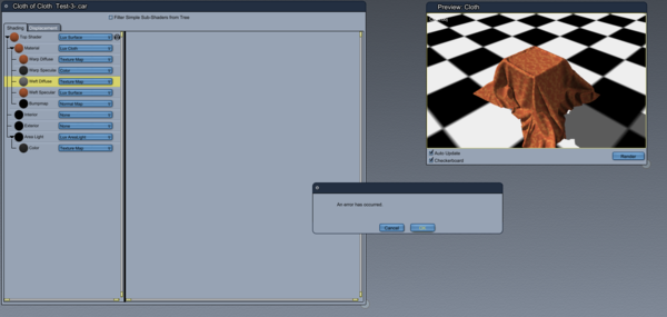

I'm having difficulty getting a translucent / SSS type effect for a wax material (for a candle). Any thoughts? I've read the documentation and seen examples done in Blender, but the Luxus materials interface does not seem to offer the same parameters. Any adsice gratefully received.
As you were, I've just spotted a silly mistake I was making and am now getting close to what I wanted!

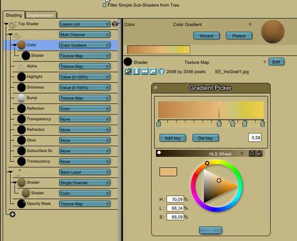

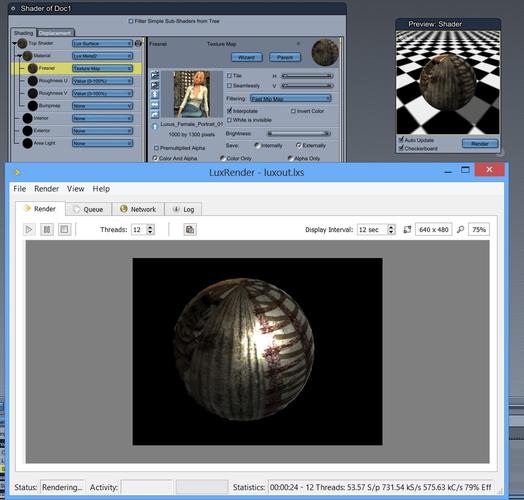

Hi, I'm having a transparency map issue with Luxus. I've set up a V4 with an SSS material using a mix material (glossy and scatter) and an interior homogenous absorption on her skin. When I render it, the lashes appear with the supposedly invisible areas visible. I've switched the lashes to a lux material using a material mix (glossy and null) with the inversed transmap as the mixer, but the result is the same. Is anyone else having this problem, and how do I fix it?

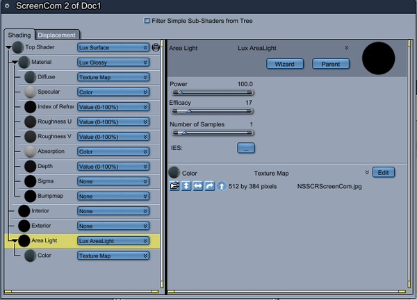

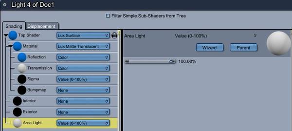

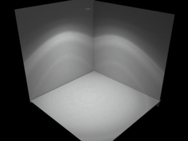

I am trying to assign an IES file to infiniti lux lightbut it is not doing anything, I tried with the projrction lux light but no render occurred at all.
Should I do something after assigning the ies file? any trick that I am missing
I think that Lux treats each polygon like a light, so to get a reasonable ies profile, just use a single small plane with a single polygon. I have used this to get some nice looking light profiles.
PhilW
Thanks mate but as you know that IES files replicates what certain lights are doing like beam lights or washers.
So should I understand that IES lights could not be used with Luxrender?
PhilW
IES files / lights can absolutely be used with Luxrender! Sorry I was not clearer, you need to add a Lux AreaLight material to a 1-poly plane, and this has a field to add an Ies file. You can also set the power and colour to suit. I have included an example below.
I think the issue comes if you apply this shader to a sphere or other shape with lots of polys - each one will apply the ies profile, and you end up with just a wash of light.

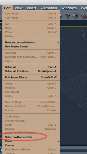

Finally have some time to play with this. Read the manual and it mentions: Luxus adds the LuxRender ligts
Infinite, Projection, Sky2, Sun, and SunSky2.
Where can i find these or how do i add them to the scene?

The extra light types can be added from the Insert menu - or even add a different light and then change the light type to one of the Lux ones.
