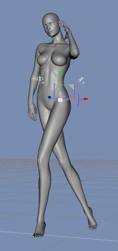

Is it possible to enlongate legs?
Just wondering. I don't mean scale the leg, but just make it longer (width stays the same). I wanna try long legs like this: http://gamingmemoirs.co.uk/wp-content/uploads/2012/11/bayonetta.jpg
If it's possible, how do I do it?
Tks!
With "Show Hidden Properties" checked in the parameters tab, you get separate dials for scale x, y and z.
That way you can scale only the height of the legs.
Thanks a lot BlackFeather! Now it works great! :)

3) It seems after I've enlongate the legs and then I add a pose on the figure, the enlongation seems to reset to default and I gotta edit the legs' length again. Any way to fix this?

3. Some poses will, some won't. Depends on how they were originally saved. Hold control when loading the pose. It'll give you a menu where you can check off the scaling.
