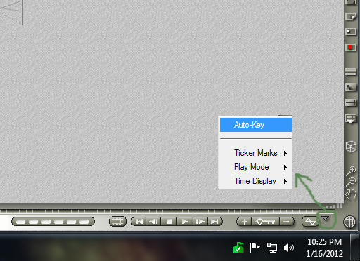

    The problem is due to a bug with animation. All you need to do is go to the bottom right of the screen and turn off Auto-Key. Then the Distant Light will accept settings changes as it should. This bug vexed me for a long time, I think it was Dan Whiteside that helped come up with the solution inadvertently.
    Make sure Auto-Key is not checked. Best of luck.

  • desperadodesperado Posts: 67
    @Rashad - Con Muchos thankos. This worked like a charm. The trackball now controls the light direction, as it should. :O)
