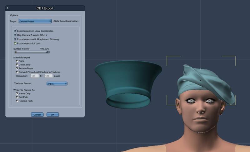

I created a hat... like the one on the left, in the vertex modeler.
Took it trough the plugin, and got the result on the right. Just as I wanted it.
But, since this is going to be just a tiny part of a much larger picture, there are going to be at least seven different hats.... I wanted to try to save on memory, so I wanted to export it out as an .obj.
No matter what, or how, - it will not export out morphed. It comes in all the time as the one on the left.
Anyone have any good ideas..?

  • You're not doing anything wrong. It's an old bug I haven't been able to solve yet. I'll have a look, maybe looking at it with new eyes will help...
  • Meanwhile, you can save it as a Carrara object. This part works at least.

  • WendyLuvsCatzWendyLuvsCatz Posts: 41,845
    I export it from the vertex room choosing the frames I want under morphs edit mode and export there
    thanks for that tip

    I made this as a static simulation, so the only morph I have is the first. But no matter what I do it won't work.
    in the vertex room with all selected on the right side there should be at least one morph called frame #
    usually even a static drape you have as many as your set animation length
    you click edit on the morph target and under  export choose obj not car
    validate to get out of that mode
  • VarselVarsel Posts: 574
    I followed your instructions , but no luck.
    With a static drape, one gets a working morph in Frame 1, the rest ( frame 2-xxx) are emty.
    There have to be a missing step here.
    But I have to admit that I do untriangulat the modell after the sim. is done.. Dont know if that do matter, but I dont think it should.

  • 3DAGE3DAGE Posts: 3,321
    Try exporting without untriangulating the model ,. if it works,....then you can edit the mesh
    I'll make a new trial tomorrow. Thanks folks...
