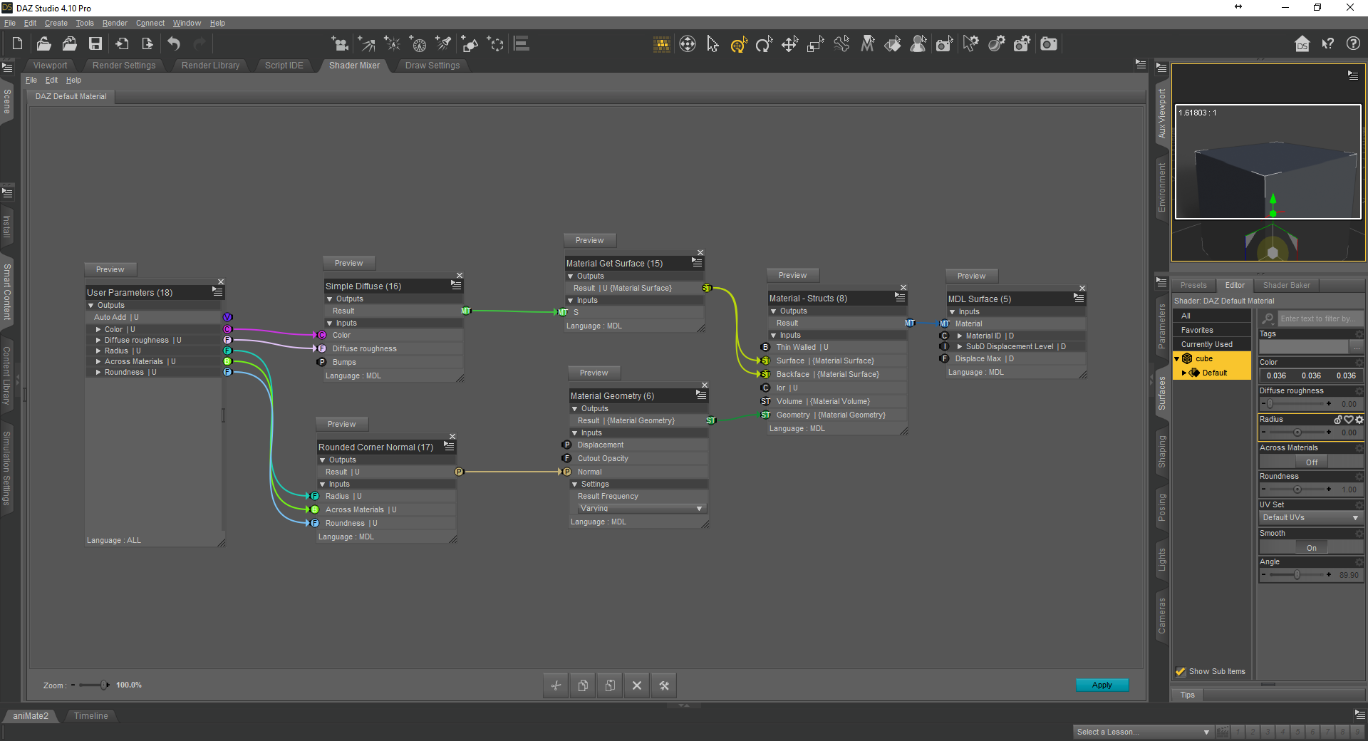

    Now I've found the "MDL/Default Modules/state/Rounded Corner Normal" and made a user input for it but I have no idea where to connect anything else and what other bricks I need, can I get some help please?
  • so the "Tech Support" was no help at all, can somebody tell me how to set up that "Rounded Corner Normal" brick please? I just need to know how to add it to a new shader.

    Returns a modified shading normal state::normal that is changed near surface mesh edges to blend smoothly into the shading normal of neighboring facets. Theresult of this function can be used to set the normal field of the material geometry structure, which results in a perceived look of smooth edges instead of a facetted look with hard edges. It can as well be combined with normal perturbation schemes.
    radius – influence radius around the edges within which the normal is modified. The radius is specified in meters in world space. A radius of 0.0 disables the rounded corners and this function just returns state::normal.
    across materials – normal smoothing happens only between facets of equal material, unless this parameter is set true, in which case the smoothing happens between facets irrespective of their materials.
    roundness – determines how round the edge will look. The valid range is between 0.0 and 1.0. A value of 0.0 chamfers the edge and a value of 1.0 gives a rounded edge.
    Is this what you require?
  • jag11jag11 Posts: 885
    Most of this info is in the MDL language specification at http://mdlhandbook.com, So I think that's the reason Tech Support could'nt help. And here in the forums a very few people adventure in the uncharted shader mixer land.
    Here is the link to a finished shader. The shader corresponds to the image below.
    Play with the shader and  give feed back of what it does or how does it work.
  • thank you jag11, the picture did the work, I managed to find the blocks in the picture and add the rounded corners to the new material. adding it to every material I have is a lengthy process specially adding the user controls, do you know any way to speed it up? for example grouping the bricks as one and save it as one brick
