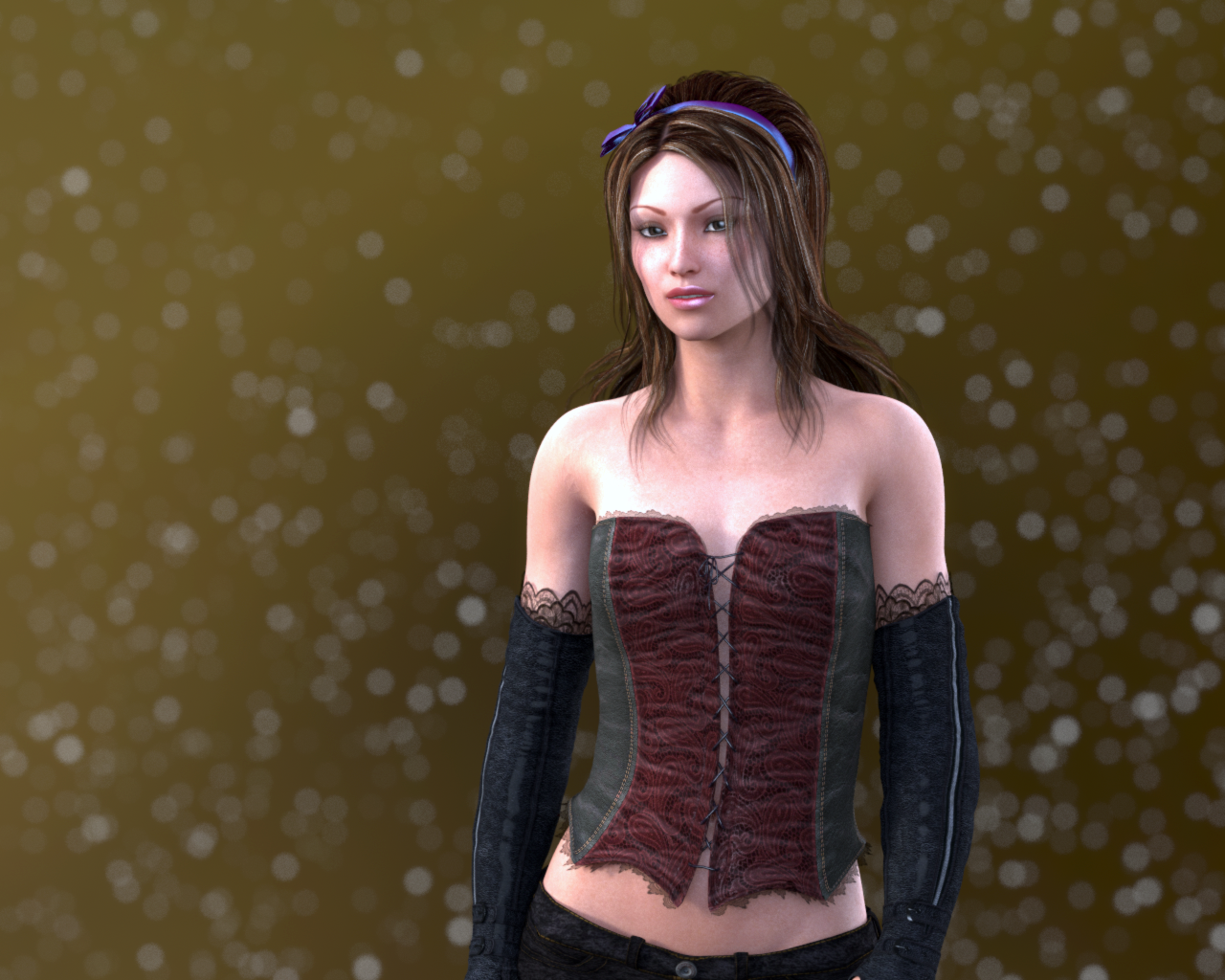

Thought I'd share the result with you... thank you again for your efforts.
https://www.daz3d.com/gallery/#images/508286/
Nice one, glad I could help
