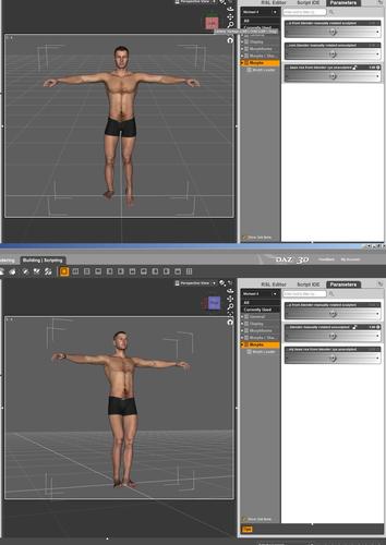

    Thanks! Using that I am able to get it to load the morph but I can never get it so that when I apply the morph it doesn't rotate the model around and distort the legs.
    In these screenshots, I did not warp the legs intentionally when I made the morph. They're some kind of artifact from the import/export. Any idea how to fix this?
    I followed the instructions from the original post in that thread to rotate it to the right orientation in blender but it comes out warped in daz.

    Michael 4 loads with the feet and legs out of the zero position. Since you've already made the morphs you could try using the reverse deformations option in Morph Loader Pro, which subtracts the current state of the figure from the morph, and in future zero the pose (right-click on the Parameters pane's tab, Zero>Zero Figure pose) before exporting. I'd forgotten about this, otherwise I'd have mentioned it as soon as I realised which figure you were using (all of the older DAZ figures load out of the zero pose, so it's something you need to check with all of them just as you need to check the mesh resolution with the newer figures which load with SubD applied).
  • edited December 1969
    That fixed it! Now it even loads into blender without needing to get rotated around! Thanks a lot!
