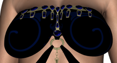

I've been having trouble smoothing clothing on a few occasions and am posting this for additional suggestions.
I have tried applying smoothing and collision modifiers and they do not solve the problem.
Attached is a cropped image as an example.
Any other suggestions would be greatly appreciated. Thanks for any information you can provide.
281 x 127 - 41K

    Sorry I wasn't clear enough in my earlier post.
    The issue is where the wardrobe item is clearly jagged around both breasts (this is not a poke-through issue).
    With the excellent quality of DAZ 3D products, I expect the wardrobe item to be completely smooth.
    After pointing this out, you can probably notice it in the original attachment, but I'm attaching a larger one for additional reference.
    Any tips on resolving this would be greatly appreciated.
    399 x 194 - 78K

    It looks like I've been able to solve the jagged edge problem by the following:
    1. Select wardrobe item from Scene tab
    2. Select the "Display the Active Pane Options" button
    3. Select Edit | Convert to SubD...
    This smooths the wardrobe item and removes the jagged edges, however poke-through appears and is not easily solved.
    I'll need to experiment with it more to find the right combination and will post the results when I do.
    edited May 2013

    I'm sure there is more than one way to resolve this issue, but I finally settled on the following procedure:
    1. Select Actors, Wardrobe & Props tab | Select Smart Content tab
    2. File menu | Open... | Navigate to and select Presets/Characters/.duf
    3. Select Content Library tab | Navigate to wardrobe folder from Products | Right-click wardrobe item | Merge Into Scene
    4. Right-click wardrobe item in Perspective View | Select Fit "" To... | Genesis | Accept | Victoria 4 | Body Suit | Tight | Accept
    - note: jagged edges and poke-through will be visible here
    5. Select Scene tab | Select wardrobe item | Select Display the Active Pane Options button | Edit | Convert to SubD...
    - note: jagged edges will be removed, poke-through will still be visible
    6. Select Display the Active Pane Options button | Edit | Apply Smoothing Modifier
    - note: most poke-through will be resolved
    7. With the wardrobe item still selected: Select Parameters tab | Select All | Adjust NipplesDepth morph to 31
    8. Adjust Smoothing Iterations to 16
    9. Adjust Collision Iterations to 5
    I considered experimenting with D-Formers and Weighting, but decided to go with what I know and work from there, although I would much prefer clear nipple definition on the wardrobe item, which I have not been able to master. Any tips on that would be greatly appreciated.
    As you will see in the attached image, the results are stunning (as always). Thank you DAZ 3D!
    400 x 216 - 88K
