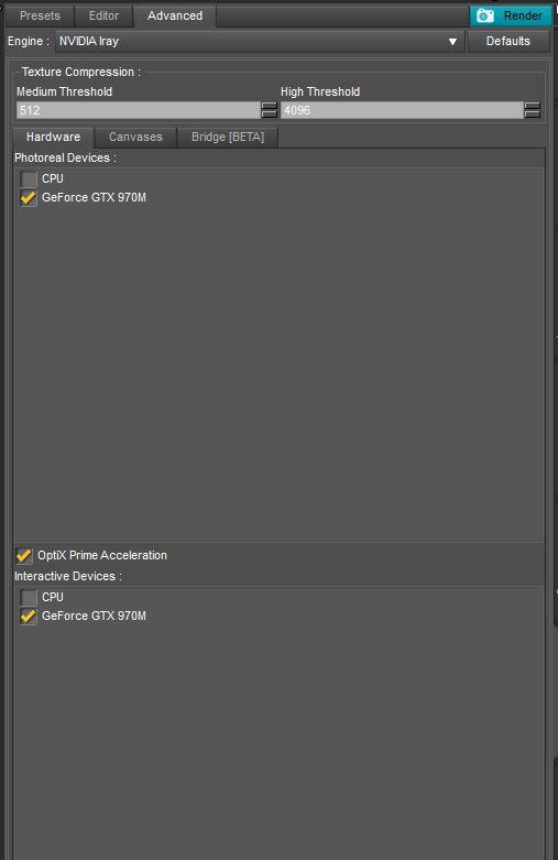

  • DustRiderDustRider Posts: 2,911
    edited January 2018
    We've always had the ability to use OptiX acceleration for Iray in DS. it's found in the Advanced tab under render settings (see below).
    From here:
    "The OptiX API is an application framework for achieving optimal ray tracing performance on the GPU. It provides a simple, recursive, and flexible pipeline for accelerating ray tracing algorithms. Bring the power of NVIDIA GPUs to your ray tracing applications with programmable intersection, ray generation, and shading."
    From here we get a bit more about OptiX 5.0. Iray in DS currently has a noise filter, it seems the difference with OptiX 5 is that is has an AI-Accelerated Denoiser .... from the article, I certainly hope we get it in DS!!!
    Improvements in OptiX 5.0
    • New AI-Accelerated Denoiser
    • Support for Volta class GPUs has been added
    • Support for motion blur by enabling motion data for Transform and Geometry nodes
    • Improved startup time and general performance improvements
    • Two new samples demonstrate how the NVIDIA Material Definition Language (MDL) can be used with OptiX
    507 x 781 - 35K
    Post edited by DustRider on

    I'm wondering if anyone in this thread knows what Optix is?   If so, they might know what the upcoming newly released Nvidia Optix 5.0 is.  cool
    I think that Optix Prime acceleration used to be an option for Iray renders but I can't find it in the render settings for Studio 4.10. Has it been removed, hidden somewhere or did I just imagine it?
    From a short web search I think that Optix may be the lower level engine that Iray is built on, but I may have got that wrong. If I'm right, version 5.0 probably means they have upgraded the whole thing a bit.
