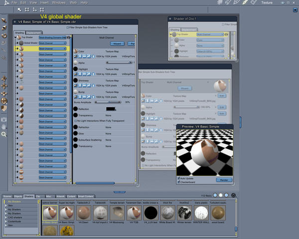

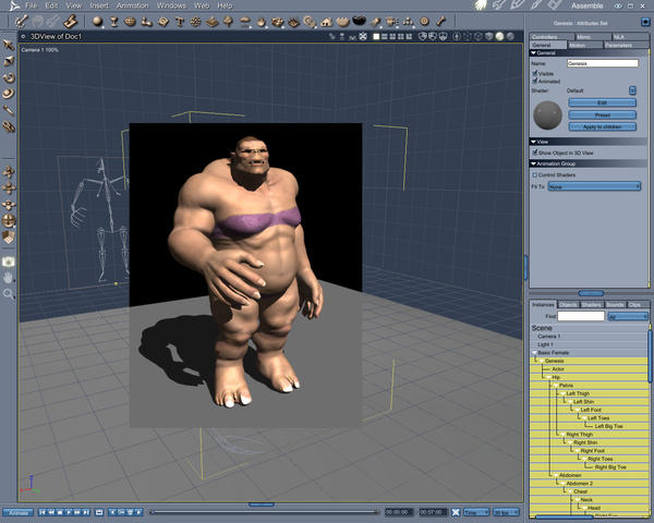

    You can use your V4 shaders on genesis,. and genesis can be any shape you want,
    The Main genesis figures do have different UV sets, so you can't use V4 shaders or texture maps on those.
    but if you begin working with a "Base Female" genesis figure. then you can use V4 texture maps, since the genesis "Base Female" has the same UV's as V4.
    the same applies to the "Base Male" figure, and M4 maps, and the Basic child can use the K4 textures.
    but you can't start with a V5, or M5 and then use V4, or M4 texture maps, since V5 and M5 have different UV's
    But,.. Any genesis figure can be shaped to be any genesis figure.. (see pic1)
    So you can start with a base female, add v4 textures then shape the figure to V5, or M5, or a troll, gorilla etc..

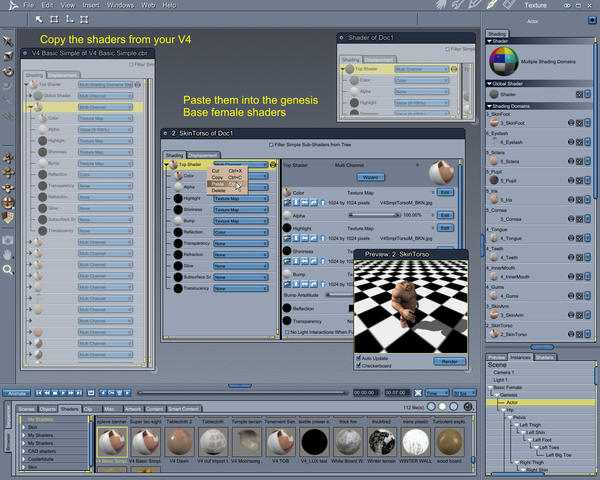

    You can apply Poser V4 shaders to the genesis base female. and adjust them as you would normally with poser shaders.
    Or,..
    If you want to apply your saved Carrara shaders,. then you can do that, ...manually
    In the shader room,.
    You can Double click your Carrara preset shader in the browser,. which will open it up as a "Multi-shading domains shader" (Global shader) which is the list of all the different shading domains,. in their correct order for V4.
    All your settings for texture maps, bump, highlight etc,. are held each of those shaders.
    Each mutli-shader channel, can be copied from your V4 Global shader,. and pasted into the appropriate shading domain in the Genesis "Base Female" shader tree. EG: Torso, Arms, Face etc..
    so it's just a matter of opening the genesis figure's shaders, and opening your V4 shader from the browser, then copying the shaders from V4 global shaders,. to genesis,. then saving that to your browser as a new Genesis V4skin shader.
    pics to help.
    / Genesis using V4's basic textures,. shaped into something truly beautiful.
    / V4's Carrara "global" shader, opened from the browser.
    / Genesis and V4 shaders

    when you're working with a shader from the browser,. and a figure from a scene together like this,.
    The shaders from the figure in your scene, will disappear from the right hand panel, whenever you select your Carrara shader, to copy a channel or setting.
    You can get the scene figures shader tree back, by leaving the figures "default shader" window open, but reduced at the top, out of the way. see pics.
    The "Default shader" will open up,. the first time you double click to edit any of the scene figures shader channels.
    hope that makes sense
