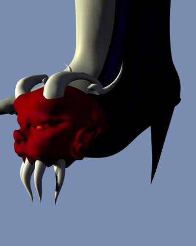

    I think I've figured out a way to help get heel matched to toe for high heels.
    Instead of modelling and tweaking the heel just make a simple cone primative and then slide it up and down and adjust the angle and keep exporting and importing into daz and fiddling with the adjustments until you get it right then leave the cone in place as a guide while you model the heel.
    I still think there should be a mathematical formula that would calculate all this perfectly but alas my brain is just too addled to come up with it.
    1000 x 1250 - 162K
  • ghastlycomicghastlycomic Posts: 2,531
    Only problem I can see might be the distortion caused by the weight map bleed from the toes may make the final rigged item a little accurate once the weight maps are cleaned up.
    You can always delete the toe bones. You can't tell me a shoe like that one would actually flex with the toes anyway. :D
    Yeah that's a possibility too, but I think I'll just clean up the weight map bleed when I do the final rigging. You can see where the foot's weight map is bleeding into the horns and the toe is bleeding into just the very tip of the heel.

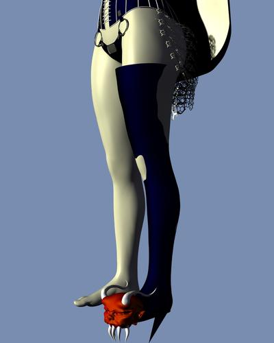

    And speaking of footware problems.
    I've noticed the Boots Thigh High projection template in the transfer utility seems to be buggy.
    If I fit the boots with no projection template they fit perfectly fine, but with the projection template the thigh portion of the boot moves forward.
    Weird.

    My experience is that when using a projection template sometimes you have to save to library, delete and reload before use for conforming to work at all.
    Okee dokee. I'll try that trick in the future.
