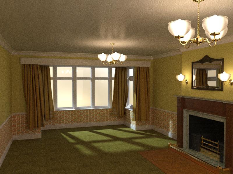

    I do have the cozy kitch living room in my library so I did a quick render.  I placed on spotlight outside the window,  spotlights are easier to aim than distance lights, Since the room set is designed for 3Delight,  had to change the window glass material to uber iray clear thin,  so it wouldn't stop the light shining in to the room.  I also place a vertical 2m emissive plane behind the camera just to provide some ambient light in the room.  The ceiling light fixtures and the wall light fixtures both have a separate material zone for the light bulb which is excellent because we can add a emmisive shader and turn them into proper light emitting bulbs.  incandescent bulbs have 3900 color temperature and the sunlight outside has a 6500 color temperature with a slight blue tint added to the color channel.  And I added a nickel uber iray shader to the mirror and cranked the refletivity to 100.  I only let it render to 400 iterations,  just to get an idea how it would look , so its a bit on the grainy side.

    Thank you so much for going to that length and I appreciate the pointers on that envrionment! I think it's a lot of fun and has a lot of possibilities if I can get to do what I want it to. My real problem though is what you asked in your first response. It's the character appearence. I attached some pictures...the first one is a rendered picture inside the room with all my crazy lighting. The 2nd is a closer one ofher face and the third is after i dragged her outside and did a spot render on her face. In the last one, you can see color contour and the gloss on her lips. Inside on the couch, she is flat and boring. Like she's drawn with chalk. I'm more than happy to fiddle with the living room surfaces but at the end of the day, if the characters look like this...it's just not a good picture.
    Again, thank you for your help and hopefully I'm not the only one that see's the problem I'm having :P

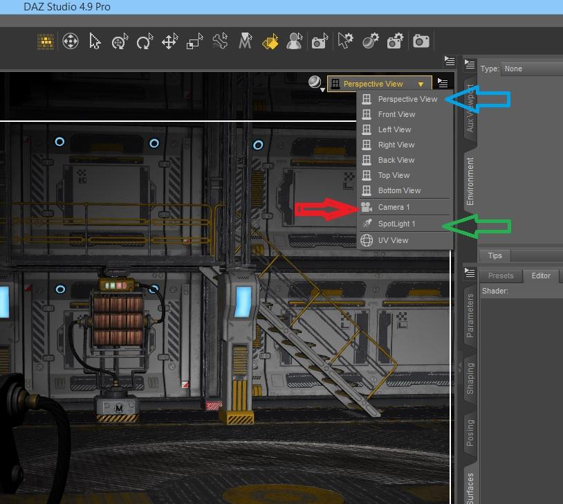

    You can indeed choose to view through any camera,  or spot light you add to the scene.  And you can simply move them around while in the corresponding view to position them exactly where you need them.  Very useful function.   Just select the drop down and select which ever camera or light you need to have a look at.  That way you can lock your camera angle for your shot,  change the view to another viewport to have a look around to do final tweaks, all the while your camera angle stays framed on the shot.  Some scenes come loaded with 20+ cameras.
