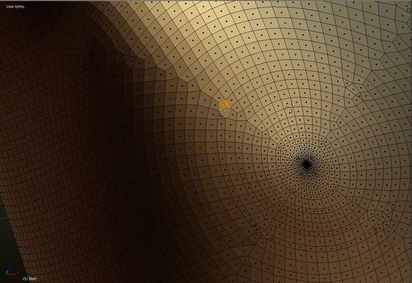

  • RAMWolffRAMWolff Posts: 10,398
    edited May 2013
    OK, created a new file with the repositioned mesh along with the older mesh with the zones in case there is a way to transfer those to the repositioned mesh.
    Another issue I'm seeing is that what I thought were bumps that I need to smooth out, some were and are smoothed now, but it left me with some verts that are lighter in color. I tried flipping them to see if that would help, nope. No good there so not sure what's causing that. These are the verts that I built when fixing the mess that ZBrush made.
    The black line is not on the suit by the way. Suit seems better now with the mirror turned on.....

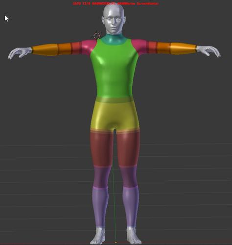

    OK.... got it done. WOW... was very easy like SY said. Funny thing about the loops I put into the suit originally in ZBrush, they seem to be strong markers so when I selected each loop as I went along and used the Ctrl + (on the number pad) it would simply stop at the end of each loop so made this process even more easy. YAY!
    Sickle, your concern about the oddity of the mesh seems to be for naught. The Ctrl + marched right up the mesh and selected every one of those verts around the pec area without a hitch!
    OK... I need to know something else. Do I need to delete Genesis when I get through taking care of some of the poke throughs? If I remember correctly I had Genesis in the scene in one of my earlier tries and even with it turned off in the properties area it still got exported with the suit. So if there is a way to keep this file WHOLE, I'd love to use it as a base file for making other clothing with this suit and I want to keep Genesis as the "manikin" if possible.

    Great, I'm glad it's working for you. :-)
    If Genesis is not selected it will not be exported. You select by right-clicking individual pieces. If you're having trouble selecting clothes without selecting the body you can hide it using the aforementioned H key.
  • niccipbniccipb Posts: 483
    Hi...
    As long as the Genesis figure and your suit are two different mesh objects, then you can export only the suit...
    In Object Mode, select just your suit... then in the Object Export options check the box that says "Selection Only" that will export only the suit...
    nicci... :)
