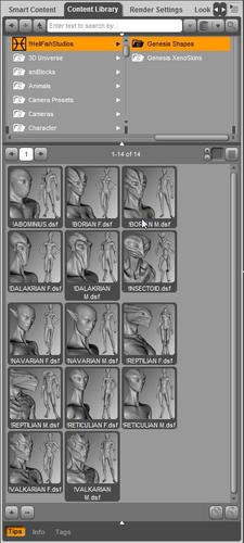

    I just bought the HFS Shapes pack the other day. In the zip file, there is a My Library with two folders, data and !!HellFishStudios. In Windows OS, I just dragged those two folders into my only DS Content folder "My Library". Can't get any simpler then that.
    There is My Library>!!HellFishStudio>Genesis Shapes with presets, and in the Shaping Tab, the morphs show up under Actor>Universal>Fantasy SciFi.

    Hi, I had the same problem and solved it : the problem is path location indeed. I made a clean fresh install of DS4.6. I created a external runtime folder because I don't want my library on the C disk.
    Everything seems to be clear in the readme file ? Yes, except one point : I have no "MyLibrary" folder in my runtime but I have in another one.
    Solution to make it work :
    As SickleYield said : " It needs to be the one that contains your Genesis.duf or Genesis.dsf in My Library/People/Genesis, if you have more than one library or runtime. ", except I have no "My Library" folder but directly /People/Genesis/Genesis.duf so it is the good library. Copy the folder !!HellFishStudios inside your library (yes on the root level) and merge the data folder with the one on the root level also. Now, when I load a Genesis figure from this library, I have the morph dials.
    For packagers :
    What confused me previously is that I have another DS runtime folder but this one contains a "My library" folder ont he same level than the "data" folder. So I followed the readme and copied the 2 folders in this "My Library" folder : it did not work because this My Library folder did not contain the genesis.duf.
    Sounds not clear, screenshots :

    Working setting (hope it helps) :
    378 x 364 - 135K
