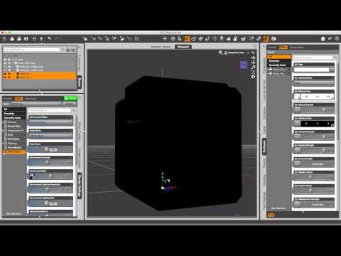

    This video might be helpful to some...
    From LAMH to IRay: a better tutorial (I hope)
    https://www.youtube.com/watch?v=UYdpH6JeSyg
    From Alessandro Mastronardi:
    In this movie I'm showing how to use Look at my Hair export to OBJ feature to have fur generated on the fly and rendered with Iray.
