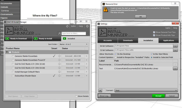

4.6 resource errors after installation?
I've just installed version 4.6 but every resource I try and use comes up with an error saying the file doesn't exist.
Whats worse is the path its following doesn't even exist in the profram files as I followed it and I seem to be missing alot of things.
Any advise or suggestions here?

  • kitakoredazkitakoredaz Posts: 3,526
    if you use Great DIM to install contents,
    as default Great DIM need new specail directory which DIM install daz contents.
    the directory is different from which you install daz studio by installer, and it show as default content directory.
    (if you leave it as default )
    so that you need to set the DIM recommend default path as new ds contents directory, by directory manager.
    then can you see where you install contents? check it by DIM setting ( click small gear icon right-top corner
    and select installation path, you can decide directory where DIM install your contents)
    and you must need downloadd and install genesis starter essential kits, (it is default contents for daz studio)
    from your account, or use great DIM.
    545 x 435 - 48K
  • edited December 1969
    I'm sure I'm just being stupid here.
    I read your post several times (Can I assume that English isn't your native language, I don't mean that offensivly I just had troubles understanding some parts! :D )
    I get this same error message on EVERYTHING (poses, people, scenes, ligths) I try to load :(
    1197 x 715 - 199K

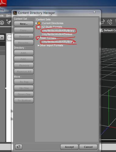

    then,, can not see any files in the /Documents/DAZ3D/Studio/Mylibrary ?
    if actually there is no contents,, you may need to re-download and install again,,
    (you may better not use "DIM")
    Then did you map the directory to CMS already?
    contents directory tab> directory manager. (right-click tab>directory manager)
    can you see your install directory under Daz studio format, and Poser Formats?
    if you can not see the directory ( in your pic,, it is /Documents/DAZ3D/Studio/Mylibrary)
    you need to set the directory as DAZ studio format and Poser fomat.
    (you can use the directory for Poser and DS contents)
    DIM is not great,, if it miss install contents, and tell you installed :coolmad:
    500 x 657 - 47K

  • Richard HaseltineRichard Haseltine Posts: 111,965
    Did you have the My Library folder selected at the bottom of the Ready to Install tab, or the My DAZ 3D Library?
    In his pic DIM show "current"="test". he choose "selected" option.
    then I think he installed contents to the Test = Documents/DAZ3D/Studio/My library :roll:.

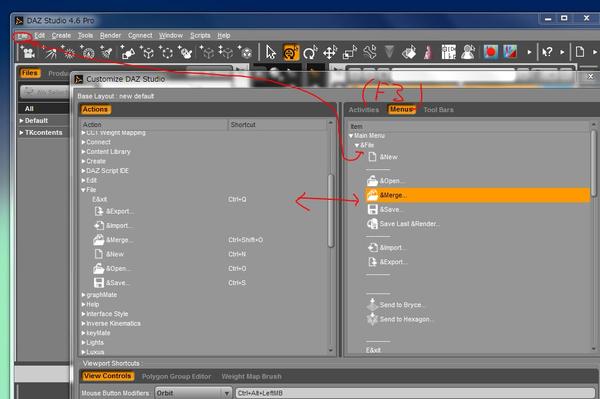

    Hi,, anyway I am glad to hear you can start ^^; sorry my bad english :red:
    then,,if you want to customieze your menu,,
    short cut key F3 (windows>Workspace>customize)
    you can add Action by drug and drop, from left Actions Pane,
    or delete "action" from each menu and tab options of right pane.
    ( I can not tell detail of how to,, but you can customize "File" menu )
