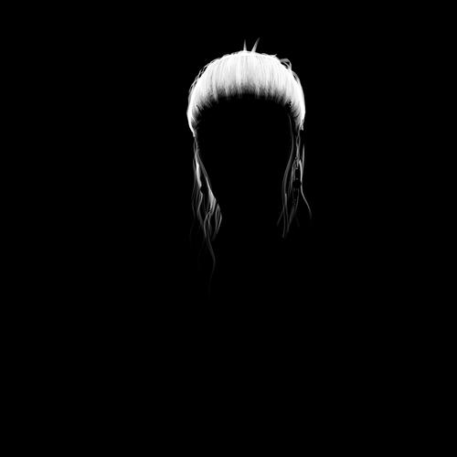

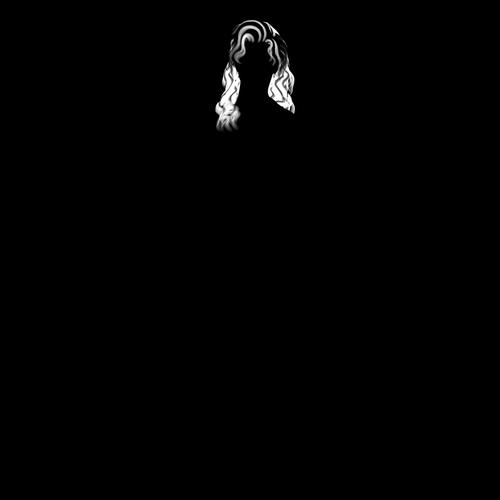

    Making progress. :)
    Currently does/supports:
    - Hides standard lights (those that show on the Lights pane)
    - Positive Masks
    - Negative Masks
    - Opacity Maps
    - EHSS/USS/USS2/DzDefault Material Displacement Maps
    Still to do:
    - Support Tiling Textures (required for full displacement map support)
    - Optionally Automatically render the results to the default render settings setup
    - Optionally Automatically UNDO the surface changes after automatic render
    - Optionally Automatically UNDO the lighting changes after automatic render
    - Support for Furify/SuperSuit Fur displacement textures.
    Right now it works like this. Select your surfaces, run the script, choose the map type (positive or negative). Then YOU have to trigger the render process. After rendering you can "UNDO" the changes using DS built-in UNDO commands (CTRL+Z, or the back arrow on the nav bar, etc.)
    Some sample masks :)
    1000 x 1000 - 129K
    1000 x 1000 - 132K
    1000 x 1000 - 36K
    2000 x 2000 - 194K
