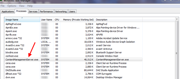

    Are you sure that the CMS is running, look in the Task manager, if it is not, you can try starting it from the location I gave you above.

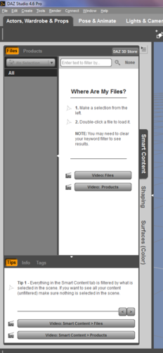

    I am having the same issues.
    Window 7 Home Premium - 64 bit.
    It is a new Hard drive, so it is a complete new fresh install of DS. No previous versions before today.
    I have no content whatsoever.
    C:\User\\DAZ 3D\Studio\My Library is empty.
    Default settings.
    CMS is running.
    Followed suggested steps... nothing.
    Don't even get the Genesis character.

    The content is in a sperate installer, called Genesis Stareter Essentials, it is about a 480 MB download.
    Did you download and install it too? If not, you wont have any content.
