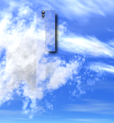

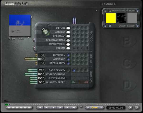

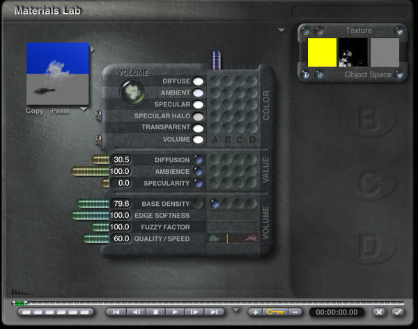

What is the most appropriate way to fix contrast problems in clouds where one part of the cloud is washed out and another part of the cloud is very dark? Nothing I try seems to fix the problem, and most things that get rid of the washed-out part also make another part of the cloud look like smoke.
I have attached a screenshot of the settings for this particular cloud screenshot just to illustrate, although it is not the only setting combination I have tried. I've mostly been messing around with the ambient and diffuse and base density settings, but perhaps that is completely the wrong approach to take.

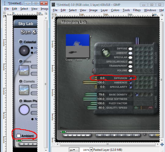

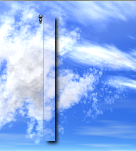

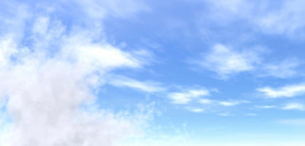

    Ok, here is what happened after going into the Sky Lab > "Sun & Moon" tab and setting the Ambient box from grey to white, and also going into the Materials Lab for the cloud and setting Diffusion to 0, and also a screen shot showing the two clouds (cubes) and their relative positions to each other in the scene:
    600 x 449 - 64K
    638 x 709 - 558K
    679 x 627 - 408K
  • srieschsriesch Posts: 4,243
    And here are my results after doing the same thing to the 2nd cloud:
    645 x 693 - 544K
    643 x 507 - 386K
    edited May 2013

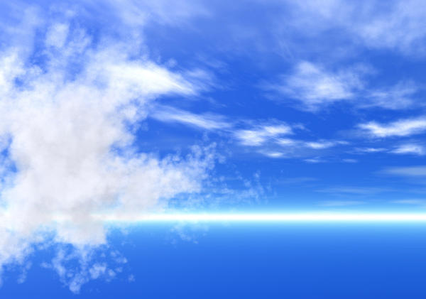

    I then repositioned the clouds so the thin wispy ones were behind the fluffier one, and messed around with the diffuse, ambient, and quality settings, and arrived at this. It's not done yet, I'm going to make the sky nearer the horizon a bit less blue, and might make other changes once I decide on the final positions of objects in the scene. I haven't bothered with the horizon line itself and below because this is going to be a backdrop for a scene where the foreground is going to be hiding all of that anyway.

    Here's the sky background edited with a slight gradient to get more haze closer to the horizon, and trimmed to approximately where it will be cut off when used.
    1022 x 492 - 421K
