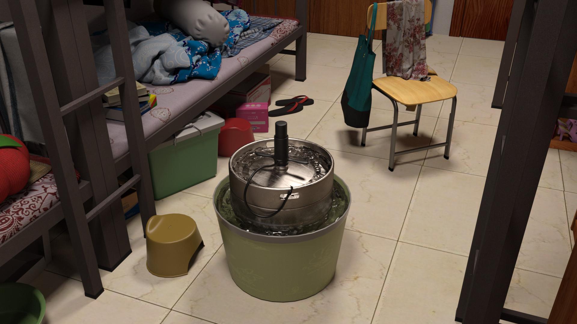

    I made some more progress on my keg project. I decided to render the keg in one of it's natural habitats, a college dorm. Anyway, I tried to create some ice, but didn't do so well. I tried taking a flat surface, grabbing random edges and verices and pulling them up to create a jagged surface. The result looks like ice that melted and started to re-freeze, not really what I wanted. I thought about using support on copy, but that would make all the cubes facing the same way and it wouldn't look random. Or I could clone an ice cube and place them all manually, but I'm wondering if there's an easier way. Anyone have any ideas on how to create a pile of ice?

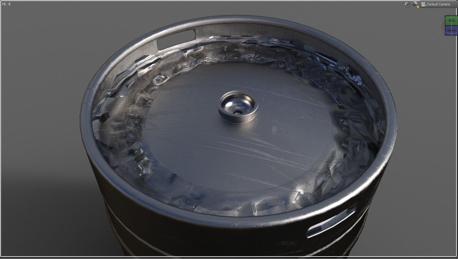

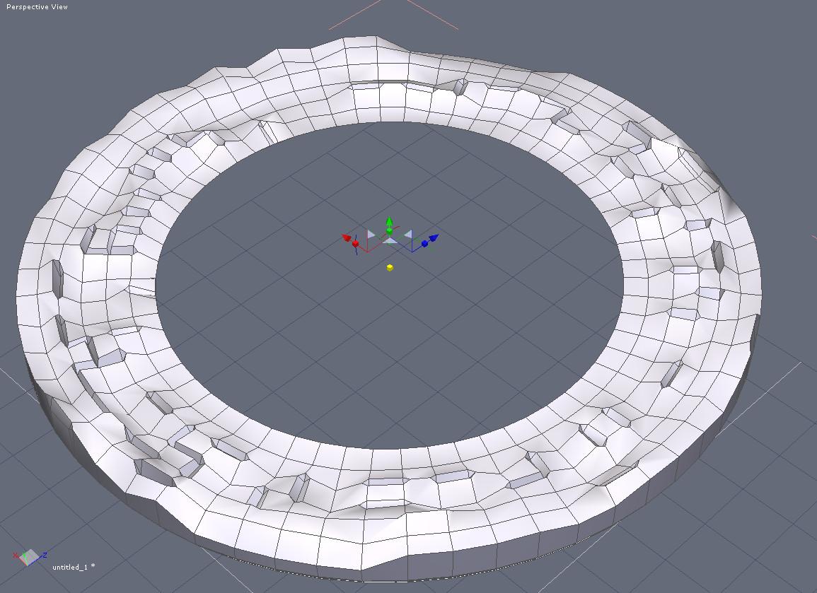

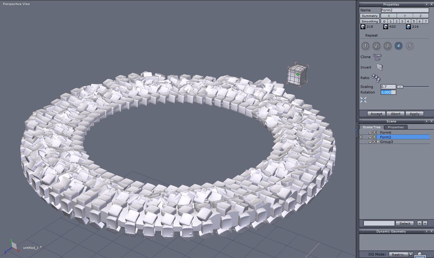

    Thanks. I got the UV map problem solved. I'm working on the beer keg/ice problem, but I didn't want to start a new thread. I tried using support on copy and like I figured, it made all the ice cubes lined up too neatly. I want them to look random. Plus, the individual cube meshes collide with each other which will probably lead to other problems later. I may just have to clone a cube and position all the clones manually.  *sigh*
    keg ice 3d model
  • It wont be easy, but I think I'd try using a grid (a very large one) then using a circle(s) on top for reference, delete the faces not needed. Then extrude random faces.
  • AscaniaAscania Posts: 1,856
    edited March 2019
    keg ice 3d model
    Subdivide your disc several times, then decimate until you're happy with the mesh. That gives you random faces to copy onto.
    That said, which version of Hex are you using? In 2.5.2.137 the copy-on-support tool seems to be broken.

    I'm using 2.5.2.137 64-bit. That was my first time using the s-o-c tool. There's a good chance I don't know what I'm doing.
    I'll give both suggestions a try tonight. Thanks.

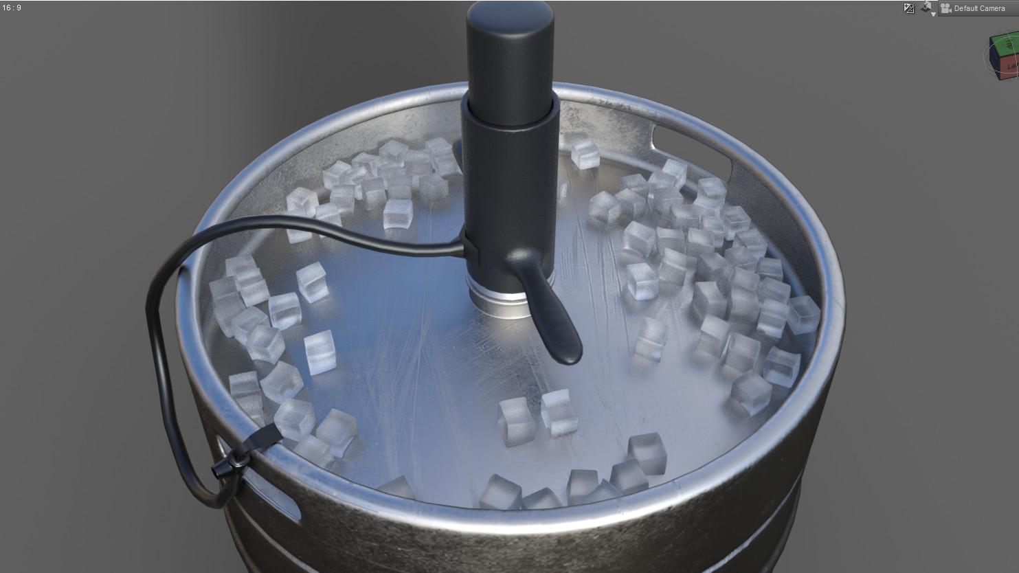

    Today I learned:
    Poser has rigid body physics.
    poser physics ice setup
    I also learned:
    Every object has to be duplicated and positioned manually before the simulation is run. I may have carpal tunnel syndrome/repetitive motion injury. Is that what it means when they say you have to suffer for your art? Anyway, dry ice cubes are a step in the right direction, I'll have to work more on this later. Thanks for viewing. Comments are welcome.
  • A3DLoverA3DLover Posts: 198
    Kitsumo said:
    Today I learned:
    I also learned:
    lol ive went on modeling jaunts that left my fingers locked up and hands shaking while my eyes experienced acid trips. believe or not randomness is also something modelers and artists struggle to achieve. i imagine youve heard of "c4d's" usually a render of a metal shaded random render used for art compositing. very easy to do in c4d or carrara, not so easy in hex. heres little random attempt using copy on support with a curved bezier line. you just start it and change views with the numbers pad. you still have to ungroup and move the cubes manually, but making em is easy.
    1024 x 768 - 292K
  • KitsumoKitsumo Posts: 1,222
    The thing that kills me about Poser is that I can't grab a bunch of objects and move them all at once. If it was possible, I could just save the scene, then move the cubes to a slightly different location, then save a different scene. Then when I merge both scenes, I'd have double the cubes, ready to simulate.
    I guess for now, what I have is pretty good. If I add some water droplets to the metal surface and put some glossiness on the cubes, it'll look more convincing. Most of the ice should be in the tub surrounding the keg and I think that part will be easier.

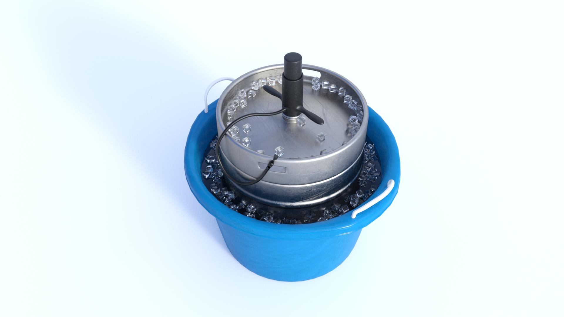

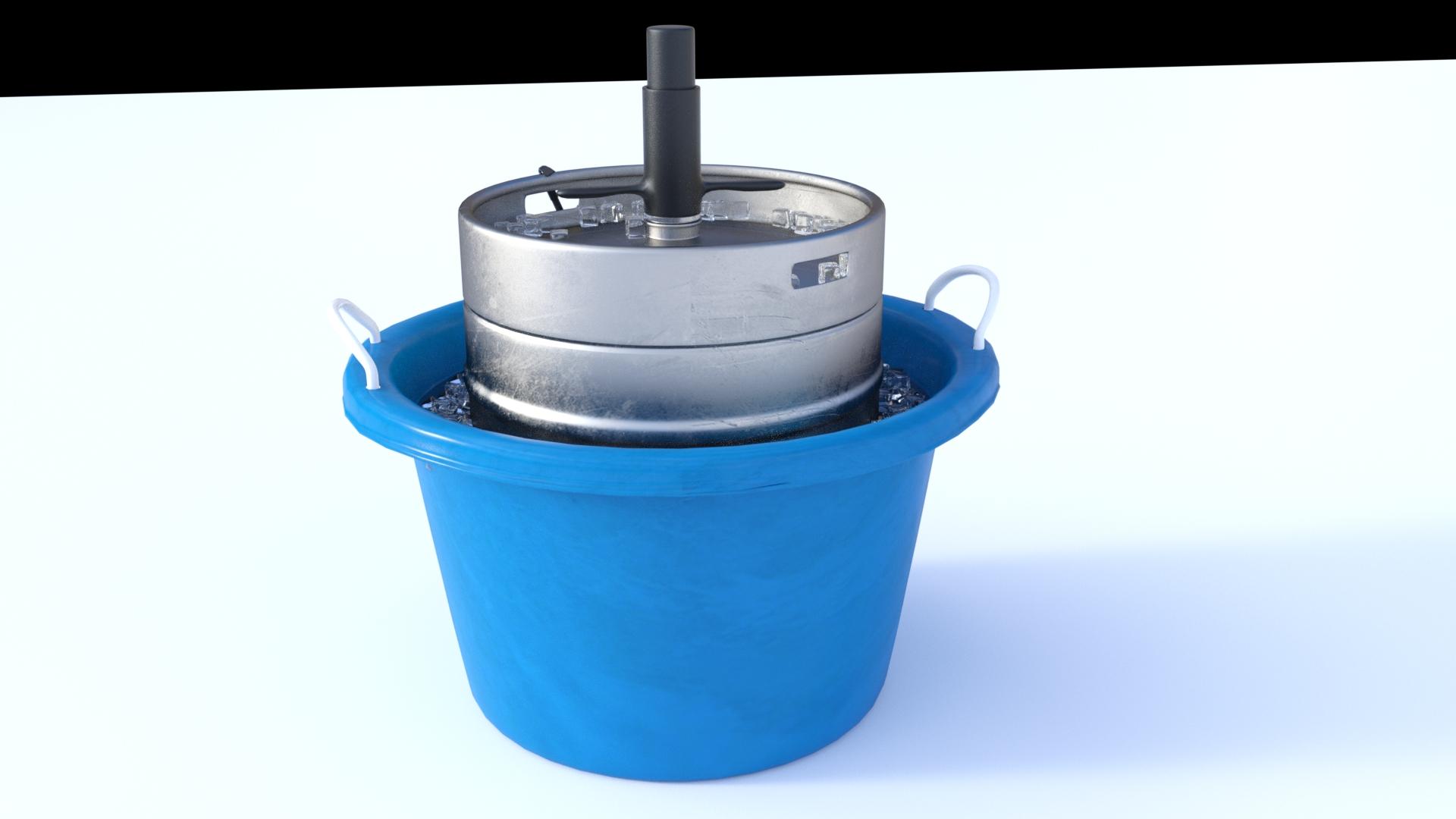

    I finally got around to modeling a tub and some ice for the keg. I decided to use instances to replicate the ice cubes, that way it would be easy to make changes later on if necessary.
    beer keganother beer keg
    It's a bit on the heavy side at around 20,000 polygons for the whole thing, so I guess I'll have to try to keep that under control in the future. I'm still planning to do 3dl textures then hopefully release it as a freebie. Thanks for looking.

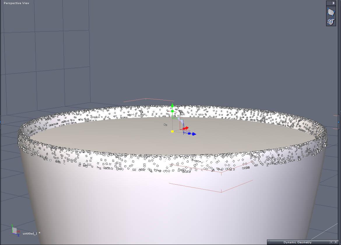

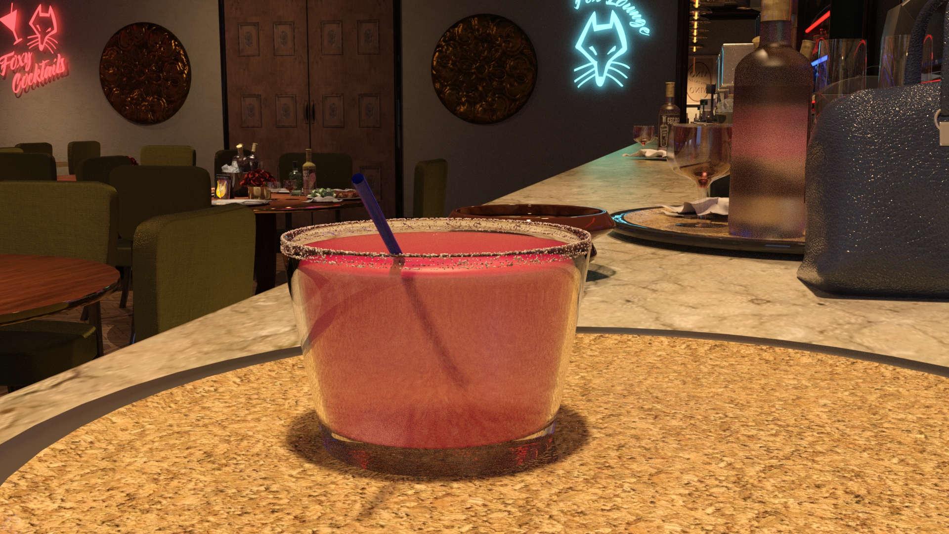

    It may not have worked so well for the ice, but it's great for salting margarita glasses! I tried using soft select to pull some of the lower faces downward, so the salt cubes would fade out gradually, but it always ended up crashing Hexagon. This is the best I could get with this model. Next try, I'll be more careful with the polygons, plus make the salt cubes bigger (and use the right type of glass for a margarita) but at least it works.
    DS support on copycocktail glass with salted rim
  • I'm not going to suggest bump maps because I think you're having fun experimenting - the best way to learn :)
    Bump maps on the glass surface or the salt crystals themselves?
