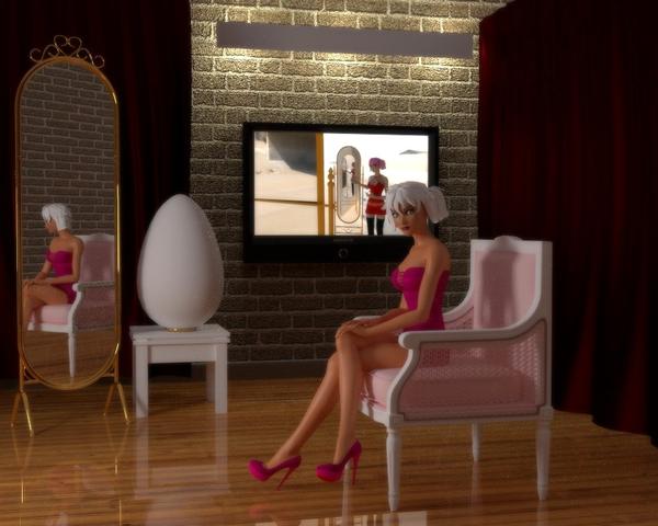

    if you have basic experience with Blender, there's my kit of scripts that lets you transfer Daz Studio scenes To Blender for rendering using the GPU accelerated Cycles renderer -- in my case it usually takes a few clicks and 5 minutes and i'm rendering
    mcjTeleBlender - render Daz Strudio scenes and animations using Blender’s Cycles Render Engine
    http://www.daz3d.com/forums/discussion/2877/
    https://sites.google.com/site/mcasualsdazscripts3/mcjteleblender2
    the drawback is that there's a learning curve
    the advantage is that, once your scene is in Blender, there's all the power of Blender for hair, particle effects, modeling etc etc etc
    shown below, a recent render -- i use it all the time ... hardly use anything else
    oh and the other advantage is that it's all free
