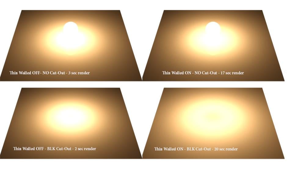

    I just ran some tests on my own and discovered something interesting. If you are setting the Cut-Out Opacity by any method (setting it to 0.000001 or by loading a black texture) the Thin Walled setting (ON/OFF) has a huge impact. See my tests below. (Note that I use a 32x32 black square for Cut-Out Opacity. A quick test shows that setting to 0.00001 had a similar result.) What you'll note is that turning OFF Thin Walled not only radicially affected the render time but affected the light disperal of the light if Cut-Out Opactiy was in use.
    Emissive Light Test Renders
    940 x 556 - 112K
    Post edited by Chohole on
  • Thanks for that!!! I'm still running a batch render now, but I will try out the thin wall setting trick asap!!!
    Thanks a lot, Me

    Ran a test with an emissive-only scene, multiple sources. With Thin Walled ON the scene rendered in 7 minutes and 38 seconds. With it OFF, 6 minutes and 17 seconds.
    TD
