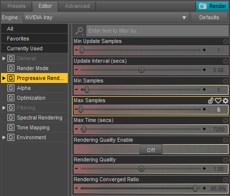

I don't know a way to pause the render, but you can set a the Max Samples to a very low value, depending on your scene and the level of detail you want in the viewport.
For a simple scene 5 can be enough to see a result.
The render in these viewports than stops after this number of cycles. This way you can speed up working with Iray in your viewports a lot.
Just set it back to the value to your need when you start the final render.

That's pretty clever. Thanks for the tip. It works like a charm.
