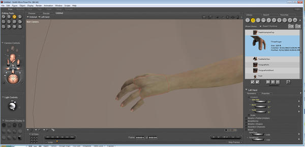

How do you et the three finger morph from the creature morph pack to work with V4.2? Im using Poser pro 2012 and can apply the morph to the hand but the fingers will not change. I've added an example of the problem, as you can see the dial for the morph is loaded into the hand but fingers remain as five rather then three. Any help would be appreciated. Thanks
Mike

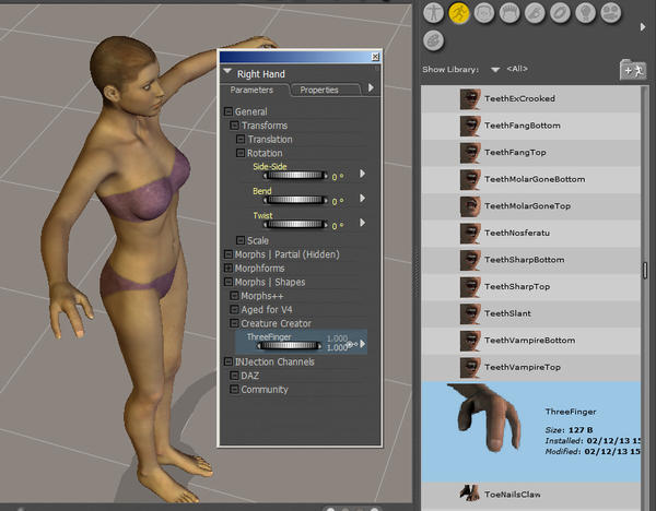

    I don't have PP2012, but I do have P8, and a screenshot is shown below, and it works the same as DS4.5 does.
    I just loaded V4, injected the three finger morph, and applied it with the dial with the rHand selected. I have no idea why it wouldn't work in PP2012, I thought V4 legacy stuff all worked. Perhaps you could ask a mod to move this to the Poser forum, you may get more answers?

    How do you et the three finger morph from the creature morph pack to work with V4.2? Im using Poser pro 2012 and can apply the morph to the hand but the fingers will not change. I’ve added an example of the problem, as you can see the dial for the morph is loaded into the hand but fingers remain as five rather then three. Any help would be appreciated. Thanks
    Mike
    1900 x 914 - 200K

    The main control is on the body, not the hands, as I recall so you probably need to clear the dial on the hands and set the one on the body.

    The dial on the body doesn't seem to have any effect. You can't dial it to 1 wont move, only -1.0 again this has no effect. The guy on the post above seemed to click on the hand and dial it in and it worked. I've tired this on both mac and pc and am having no luck with either version.
