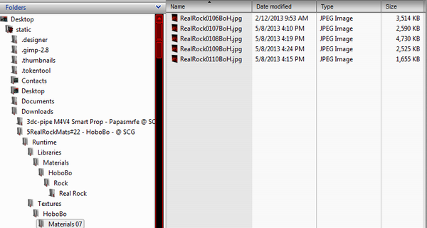

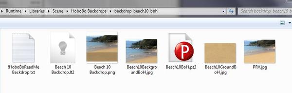

As you can see by the folder structure in the two Folder pictures, they are set up to work in Poser, but I don't know how to get them to show in Studio. I navigate and just get an empty folder.

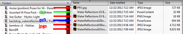

The other picture, water reflections, also for Poser, seems to have no folder structure at all.

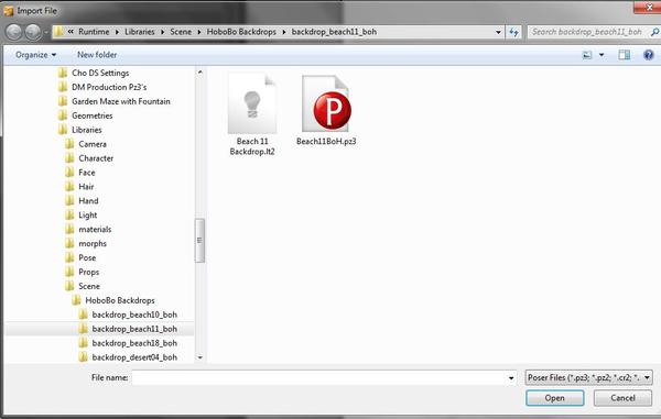

    I have used some of HoboBo's .pz3 files though. You can unzip these "anywhere you like" - put mine in Runtime/Libraires/Scene/xxxx as shown in the attached screenshot. To use them in DAZ Studio, you need to do File->Import then navigate to wherever you've put them (you will need to pick "Poser files" in the dropdown filetype as shown in scereenshot 2) and import. DAZ Studio will then do its best with them. Note that HoboBo seems to hardcode a filename for the .jpg texture files which DS will be unable to find on your system - you just need to LOCATE and navigate to the same folder to shown DS where to look for them.

    Actually I take it back about the .lt2 files - they do seem to have some useful effect in DAZ Studio. I just tried the one from HoboBo's beach set in the above screenshots. I believe the trick is to put the files into Runtime/Librarires/Scene, then if you go through the Content Library to that place DAZ should show both .lt2 and .pz3 files.

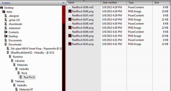

    Did a bit of digging (googling) on the .mt5 files and found this forum reference - maybe some help?
    http://www.daz3d.com/forums/discussion/20092/#305894
    ETA: Read on from that point - the useful answer is a couple of posts down.
    I tried just renaming one of HoboBo's .mt5's to .mc6 and it worked to some extent - as with all poser materials used in DS, you will probably need to tweak them to get the best results.
