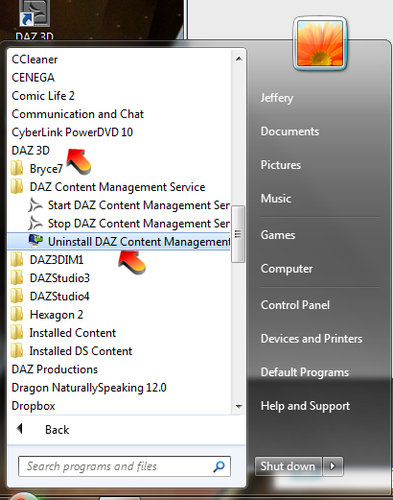

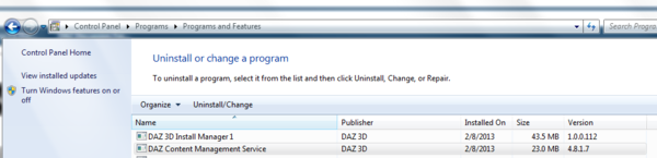

  • JaderailJaderail Posts: 0
    Win 7 has two methods to Uninstall. One is in Control Panel called Uninstall a Program
    The other is in the Start Menu > Programs the Daz3D and tada..
    Also the CMS shutting down at a whim is Often a sign the DataBase is corrupted.
