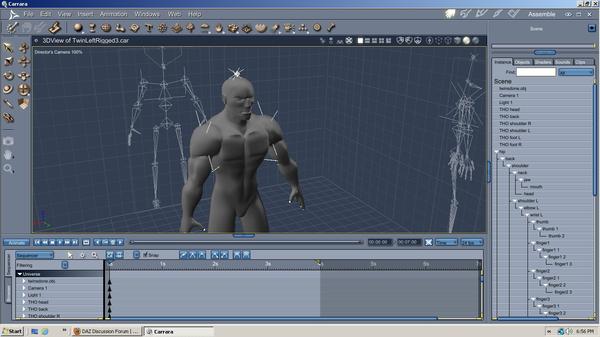

Hi,
I got my rig all set up with weight paint and all seemed good but then when I started to place the helper objects, I found an issue. The model starts to swim around as I zoom in with my mouse wheel. I noticed the motion isn't placing new key frames like it normally would with motion, so I'm not sure if this is a glitch or what. Anyone else have this issue or know a solution that can fix this?
Thanks

  • 3DAGE3DAGE Posts: 3,311
    Hi More2burn :)
    What version of carrara are you using ...is this happening in the 8.5 Beta, or in 8.1 ?
    what OS and graphics card. ?
    Any more info on what you're doing, and how you're doing it, or screen-shots of the figure / bones / instance list etc..can be helpful
    for example,. are you using he IK chain tool,. to create the IK helpers,. or are you adding a target helper object, and using "IK target" to select that helper object.
  • More2burnMore2burn Posts: 0
    Carrara 8 8.1.1.12
    Vista
    Nvidia 9500GT
    I'm adding a target helper object. Selecting the bone I want for that object and going to the modifiers tab where I then select the helper object that I made.
    1366 x 768 - 160K

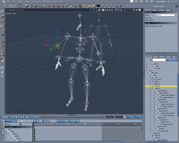

    edited May 2013
    I decided to try and repair the rig so I wouldn't have to do everything over and may have found more clues or just another bug :(
    Back when I set the bones, I duplicated the arm and leg on the X axis so I wouldn't need to do it all over and I think there is a tut that shows this is OK. Problem is that the duplicated side is messed up when you use the IK chain on the shoulder for example. It shoots up in the air, as does the leg when you apply the chain. I don't know what could be causing this.. Must I really do every bone without duplication? Argh!
    So I started over and built all the bones again and it's the same thing on the duplicated side. I did the opposite side. I did skin it to the model and then detached it to check that it wasn't the model and it does it without being attached. I just placed the bones and didn't add constraints or anything else.
    Is there a way to save the weight paint map out? So much time to make up.
    Well, I started using the IK chain tool, and tested it on the original and the brand new skeleton I started over with. I was very cautious when I made the new one and didn't do any constraints or weight paint at all. I got the same issue with the duplicated side as before. I think it's the left side that is messed up on the new one.
    Here: https://bugs.daz3d.com/file_download.php?file_id=28307&type=bug
    Anyway, If you click on the upper back for example and then select the bad shoulder with the IK chain tool. It should shoot up in the air as it does for me, and screw up your model in the process. :(
    This is probably what caused the movement bug but cant say for sure. Is there another bug with duplicating bones?
    edited May 2013
    OK, it seems like the issue is with the IK and not the bones? I don't know for sure because only the duplicated side is effected negatively. Either way, is there many limitations with the types of rig you can create in Carrara, as opposed to those made in other software?
    I wanted to have IK controllers for all the normal places and it seems like the workflow is special in Carrara, or it can't be done without bugs? Is there special rules to follow in Carrara? Is there any tutorials out there that show a more advanced rig with IK controllers in all the normal places on a humanoid character? I've seen simple ones but if you take it too far does it always bug out?
    Any tips would be helpful for my next attempt.
    Hi More2burn :)
    Sorry for the delay in getting back to this one,. I've been out doing other stuff, and I'm not really back yet :) so,.. bear with me.
    A quick look at the rig you sent, shows the "elbow" is an issue,.. The elbow is connected to the shoulder, (as it should be), but it's not connected to the hand bone (wrist)
    and the wrist is connected directly to the shoulder, which means it cannot bend at the elbow (see pic) where I've moved one elbow,. so you can see.
    I'm not sure if there's some reason to built it that way for your model, but the Shoulder (Upper arm), should connect with the elbow (Forearm) and then connect to the Wrist (Hand) ...then you can add an ik chain by selecting the Shoulder bone, then the hand bone.
    I'm also not sure of the advantage of using "duplicate with symmetry" when creating bones, especially given the current issues your having when you're using that..
    I would simply draw the left and right bones manually,. (do this as a test to see if you get the same results as you do when using Duplicate with symmetry)
    if you use the front view, then you should be able to use the Background grid spacing to line up the joints on both sides.
    As Tbwok mentions,. the rigging in carrara is as viable as rigging in any other program, and (IMO) much easier and faster to create bones and add those to a model than many programs.
    But, saying that it's easy,.. is relative to how familiar you are with rigging
    quick little example file :
    https://dl.dropboxusercontent.com/u/7907045/Ik_test_rig.car
