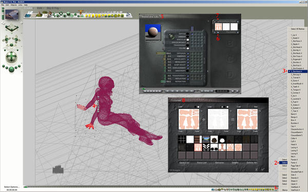

    @Misty Whisky - Perhaps this helps.
    1: Access the parts by clicking on the down arrow.
    2: Click on Select Mesh.
    3: Find the mesh, here Hitomi's skin for the hands.
    4: Hand skin is selected, click on M.
    5. The material Lab opens.
    6: Selects Picture material, the button has a P in it.
    7: Opens the Picture loading dialog.
    8: Pictures dialog. Left is colour, centre is alpha, right is sum.
    Though I'm not sure whether this answer your question.
