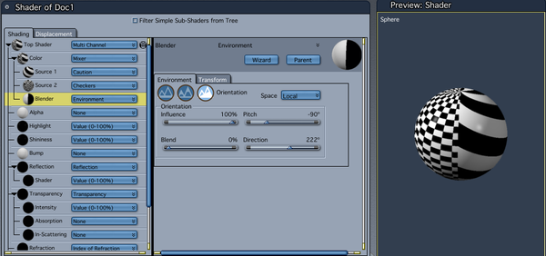

    The Environment shader has a rotation control. Set the Orientation tab to 100% influence. Set the other tabs to 0% influence.
    The Direction parameter rotates the shader.
    The Blend parameter sets the blend zone.
    963 x 453 - 133K
    Holly, your suggestion did the trick! I did a test render it was precisely what I needed.
