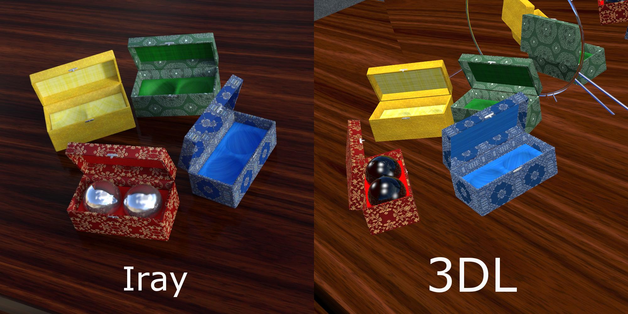

So I made a prop set of Chinese health balls and case.  I did mats in iray, then decided "why not support 3DL too"?
Problem is, I can't get the proper metal effect on the balls.  I used to know my way around 3DL a lot better but this isn't working for me.
Attached is a comparison - the 3DL image also has a mirror prop from Daz - that looks great, so I tried copying the settings (no mats involved - right ball only has a bump map) - but the balls come out much darker.
I've got Diffuse at 0% (also tried other settings), Reflection at 100% (also tried 80%), and specular strength at 0% (also tried 50% and 100%).  I also have a 360 degree skydome, lit with ambient at 100%.
I seem to recall I've had this problem in the past with curved mirrors in 3DL.
Any help appreciated.

    That's what I figured I'd start with and tone down from there - but I'm just getting the dark colours.  As a comparison, I tried a DS default primitive sphere out of the box and adjusted the settings to those you mentioned and got the same result.
    Raytrace depth is set at 4 but increasing it to 8 made no difference.
    The mirror in the image has the same settings and works just fine so I'm not sure what the difference is with the spheres.  (Adjusting the camera, the mirror also reflects the darker spheres as darker and it reflects the skydome perfectly).

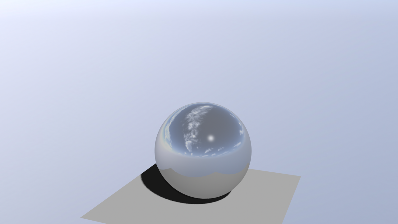

    They are reflecting, they're just not silvery shiny... try increasing the diffuse strength/tweaking the diffuse color.  I just tried one of the Gemologica presets, and that has the diffuse at 100% strength (in a medium taupe for this case)

    Quick test scene:
    1280 x 720 - 2M
    Post edited by Sven Dullah on
    edited December 2017
    Quick test scene:
    What's your light setup? I used an AoA spot centered at the sphere and some AoA amb light.
    Raytrace depth 2, everything else is overkill.
    Well this is a bit odd. As for my test scene I used a DS primitive but pretty high density mesh, don't know if that would make a difference, don't think it should. The material was pretty close to what I suggested, diff strength at 3%, reflection strength 97%

    That test scene looks like a perfect place to start.   Really not sure why I'm not getting it.  I'm using the latest DS (4.10.0.123), 64-bit.
    I'm just using 3 distance lights (skydome set to not cast shadows) - Tried adding a spotlight too.
    Thanks for trying to help, I'll keep experimenting.

    Thanks, but yeah - I'm using a 360 skydome - if I move the camera, the skydome reflects just fine in the mirror, just not the balls.  Edit: or rather it does reflect in the balls, but the balls don't look metallic, just dark.

    Update - playing with it just now - flipping the normals with the geometry editor has led to progress (weird, as a default DS sphere primitive was also misbehaving).
    This is an improvement at least - I think remaining darkness here is actual reflection.

  • Turns out it was mostly the lighting model - setting it to metallic gave dark results but setting it to glossy-plastic made it more shiny.
    Kyoto Kid's settings in this thread https://www.daz3d.com/forums/discussion/comment/3161441/#Comment_3161441 did the trick.
    Thanks for getting me most of the way there :)

    I know it doesn't matter anymore but still puzzled by the different results. So did some more testing. Progressive off made no difference. Made a new simple scene with only a primitive sphere, a plane and a distant light with raytraced shadows and tested all the lightning models except matte. This is what I get:
    Plastic:
    Glossy Plastic:
    Metallic:
    Glossy metallic:
    As far as I can see the only difference is the specular model, and it seems like metallic and plastic are identical, same with glossy metallic and glossy plastic.
    Tried same scene with only camera headlight and got the same results. Go figuresurprise

  • DaWaterRatDaWaterRat Posts: 2,887
    You have a skydome in that scene.  Maybe on Uber Environment?  3DL doesn't have a default environment.
    Yes I have a 3DL skydome, a plane, a sphere and a distant light, no UE2 or anything else. In the first test (see above) I used AoA amb+ AoA spot. Same result with the metallic lightning model. Point being none of those turned dark as for Silent Winter.
