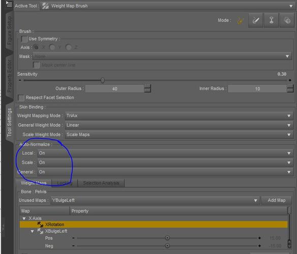

  • Richard HaseltineRichard Haseltine Posts: 111,937
    Kattey said:
    Wait, new DS has an option for non-normalized mapping? O_o
    Yes, normalisation is on here (I just selected Genesis) but this si where it's turned off.
    722 x 618 - 62K
  • KatteyKattey Posts: 2,899
    Does it mean that several bones now can weight-affect the same area, with added up strength more than 100% instead of 100% we have now?
