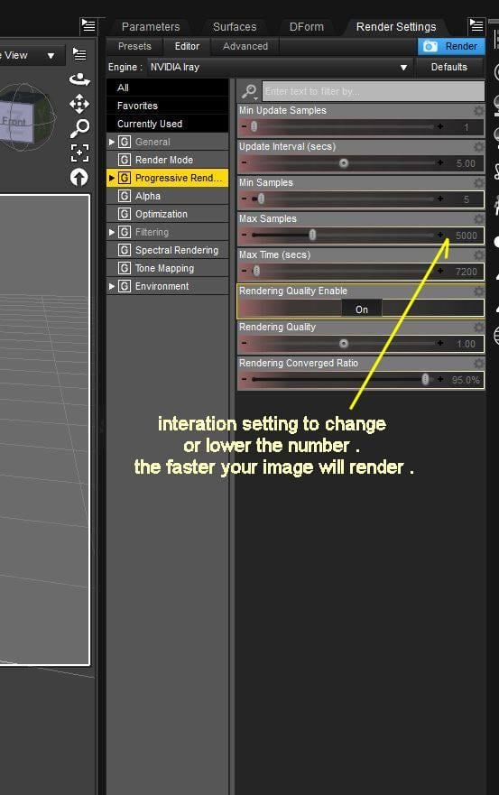

    I can't vouch for  the camera thing speeding up your renders.. But under the render setting  if you adjust your iteration setting as low as possible around 80  then raise the iteration number up  until you get a good clear picture your find you'll be around 1000 iterations with most images..  which will speed your render times 4 times faster than if you had them set at the default level of 5000 iterations. ( see screen shot 1)  If your going to render animation with Iray this would be how you would cut your renders times down.  I usually can get away with a 300 iteration in a scene if its well lighted  and depending on how much I have loaded in the scene can takes anywhere from 30 seconds to 70 seconds a frame, if I have a darker scene I will apply the firefly filter set to around 300  to rid those pesky fireflys you get with darker scenes specially if your using HDRi that are dark in natural light. . But I generally start with iteration setting to speed up render times first. the only thing i use the camera setting for is DOF or something like that

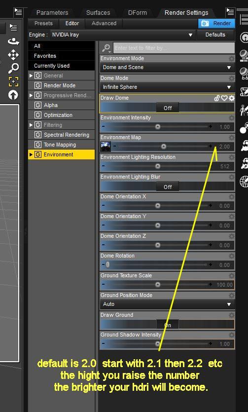

     also under the render settings tab . you can boast the environment brightness but rasing the the HDRi map value  see screen shot 2
    I included a couple of screen shots for you

    Ivy, thanks for the screenshots, in number 2 there are 2 sliders of interest there, Environment Map and Environment Intensity. I wonder if using these to increase light levels actually increases the render speed. As to reducing iterations, I do that to some degree, and it certainly saves time, however in portraits this is rarely an option as quality is often the critical factor.

    Yes that is what you want to you use to brighten your HDRi scenes .though I very seldom use the environment intensity slider unless its real dark, I would start with the map setting s first. A little goes along way .   So I recommend you do it in point decimal increments . like.1.1  1.2  1.3 etc. if you do it in whole numbers , it will give you undesirable results of being to bright. but if you play with them a little bit you'll see what I am talking about
