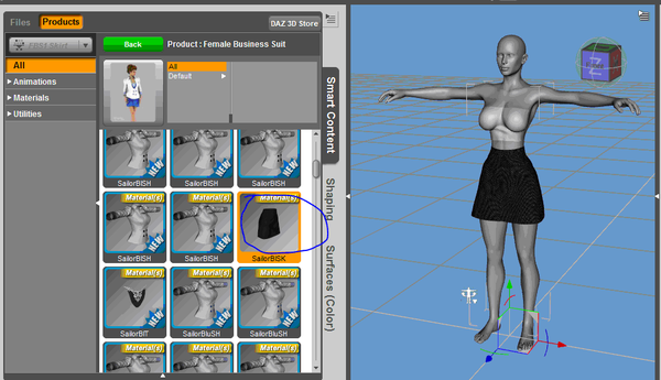

    Screenshot#1
    First, I am selecting wardrobe item by double clicking on it:

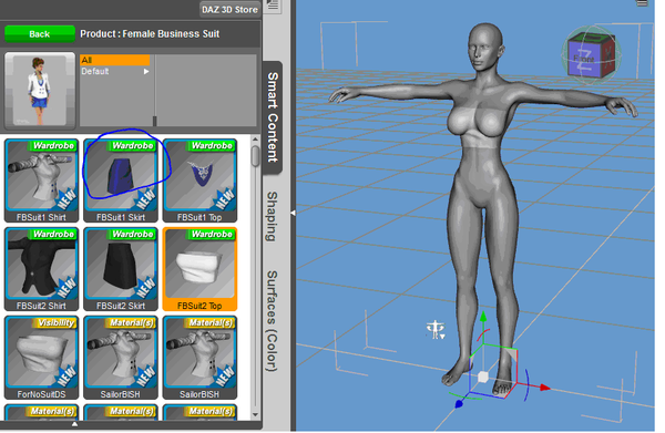

    Screenshot#2
    Next, I would like to select a material item from the same smart content folder, but when I double click on the material item, nothing happens:

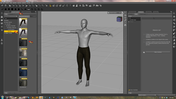

    Screenshot#3
    To get this to work, I have to right click and select the wardrobe item, but when I do this it boots me out of the folder.

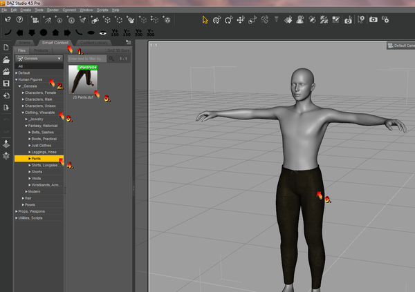

    (after wardrobe item selected)
    Screenshot#4
    I now have to go back into the smart content folder and find the material item and now it works, but there has to be a quicker way to do this from the smart content folder

  • JaderailJaderail Posts: 0
    edited May 2013
    Try to follow the pictures I think it explains the way pretty well. It's not a one step but much faster than what your now doing I think.
    1. I load Genesis then a item
    2. I select the item
    3. I go back to Smart and get just the items list.
    EDIT Notice I'm using FILES not Products.

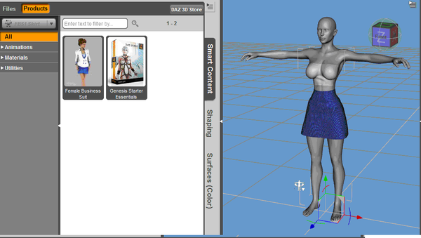

    One way that might allow you to accomplish what you want is the old click, drag and hold method.
    1. Load your Figure
    2. With it selected in the scene tab find your wardrobe piece (if you're using the product view you'll also see all the mats)
    3. Either double click the Wardrobe item or click, drag and drop it on your figure.
    4. You should still be in the product tab for the wardrobe item you just added so you can see all of the materials available.
    5. Find the mat you want and instead of double clicking it. Click, drag and hold it over the wardrobe item you just loaded.
    6. A popup will appear and at the bottom of it you can choose to apply to the Figure or Apply to the wardrobe item, choose the wardrobe item.
    This seems to work with most things though I couldn't make it work with CoolSports for Gensis.
    You can sometimes even just drag and drop the material directly onto the item and it will take.
