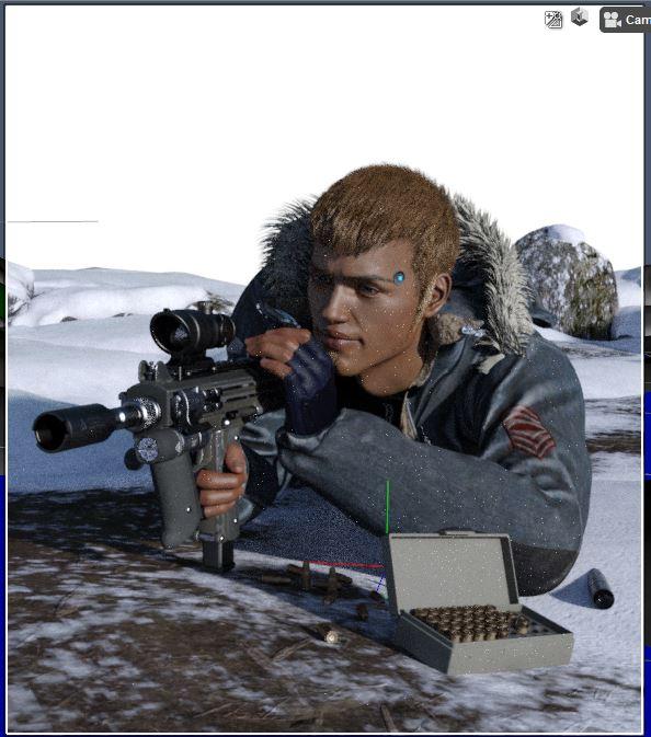

    This is what happens to me. The dome is on. And I can tell it works because when it renders it shows up.
    594 x 673 - 73K

    What skydome are you using in that scene? What does the rendered imge look like?
  • FishtalesFishtales Posts: 6,232
    It is too bright and is being washed out by the Tone Mapping settings i.e. it is overexposed..

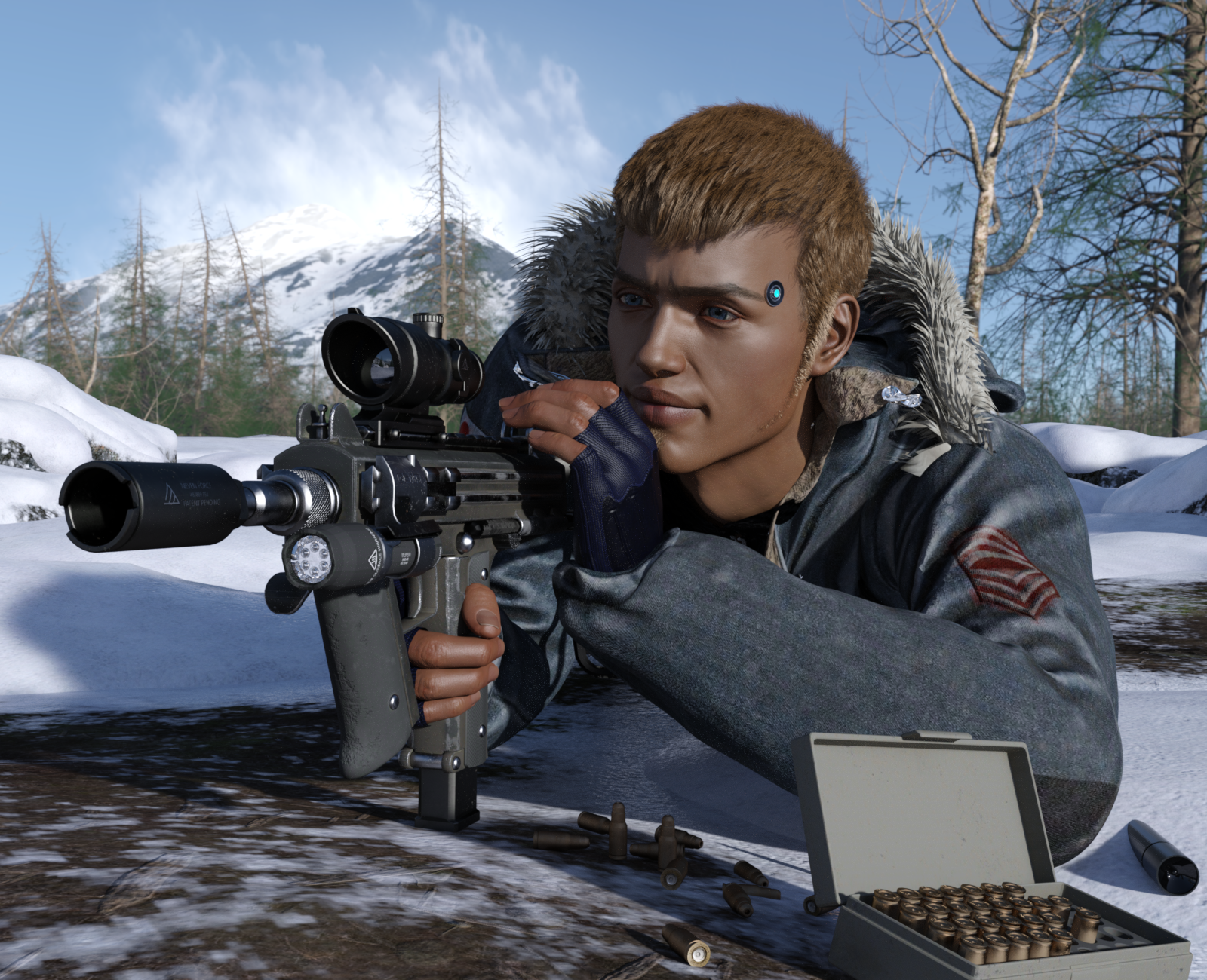

    This is how it renders with the HDRI in the background. I have to fix some stuff, but... this was just the test render.
    1600 x 1300 - 3M
    That's a beautiful background. I hope you can resolve why it doesn't show up in the Iray preview. How else can you effectively position it?

    There is a difference between the Preview and the Render. The rock over HIS left shoulder is in the Preview but not the render which suggest that the dome isn't big enough to cover the scene if it is a prop. Unless of course you have changed some things in the background :)
    From the notes on the page for the HDRI's
    Note: in the Iray Render Settings you may need to adjust "dome radius" and "ground texture scale" to match different camera settings
    Which was the other thing I was going to suggest that if it is set to Finite Dome the radius might need adjusting.
