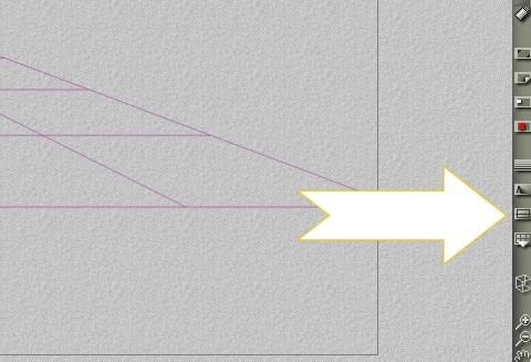

    Edit. Disappearing terrain, might be the underground on/off control - if your terrain has slipped underground it will vanish if you have the horizon turned on. See attached image to show where this little switch is located.
