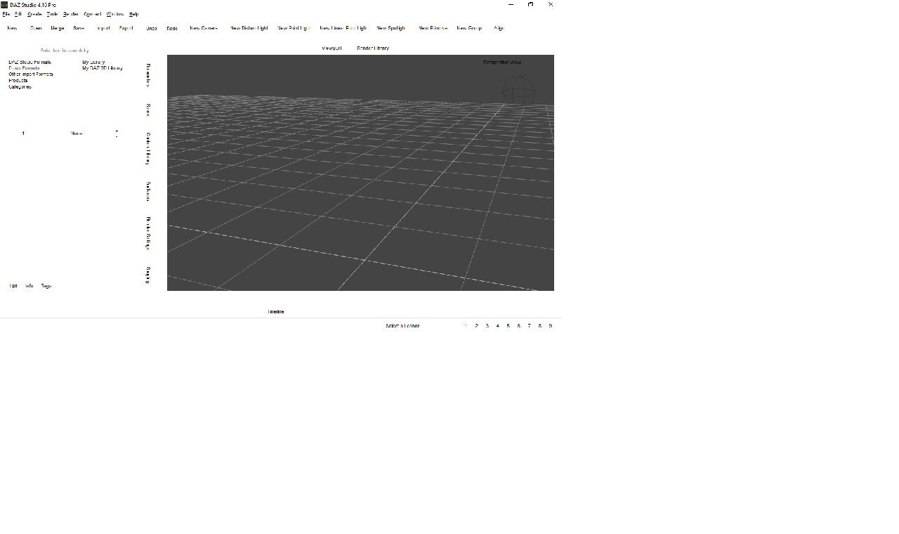

Interface since the "update" gone white
IkyotoIkyoto Posts: 1,159
It's unchangable and I can't get to many featues.
1280 x 760 - 84K

  • That usually means DS was open when the new version was installed. Close DS, and make sure it really is closed in Task Manager, then uninstall and reinstall.
  • ImagoImago Posts: 5,794
    No need to uninstall and reinstall, just go to Window->Workspace and select a Layout. It should solve all.
    No, the white-out is caused because a file or files DS is using cannot be updated and become corrupted, it is necessary to remove and replace them (by uninstall/reinstall). This is a Style issue, not a Layout issue.

    Looks like an old thread, but I just experienced this as well. DAZ Central just reported on the dashboard that I didn't have DAZ Studio installed even though I installed it long ago via the legacy DIM. After DAZ Central said I didn't have it installed the windows went white.
    When I opened DIM  to uninstall/reinstall it no longer recognized that I had DS installed; so, there was no option to uninstall DS in DIM. But, in DAZ Central on the dashboard I clicked the prompt to install DAZ Studio. It appeared to go through a short repair process which fixed the issue.
    Hope this helps..
    Hope this helps..
    Daz Central looks at more than just the core application - it also checks to see if soem add-ons are installed. If choosing the install option was quick that probably indicates that it was just some plug-in or small content package that was "missing".
    If you were using custom paths, especially for the Manifest Directory in DIM, then Daz central will have reset them - that would be wgy it doesn't see the application as installed.
  • AngellsAngells Posts: 120
    I fixed it by going to Dim, and it said install Dim right away. It installed and I got my screen back no more white screen. I didn't have to uninstall DS, I won't install DC again. Second time I installed it gave me problems.
  • This happened to me as well, I reinstalled the update and it cleared up the problem. I find Daz Central far inferior to DIM, it has no depth to look under the hood. Please keep DIM!
