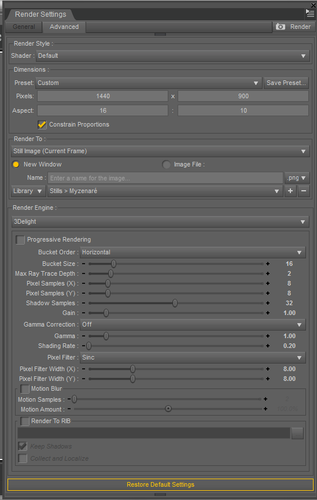

    What are your render settings?
  • staticstatic Posts: 325
    My Render Settings are below.
    548 x 865 - 42K
  • SzarkSzark Posts: 10,634
    Render settings look good.

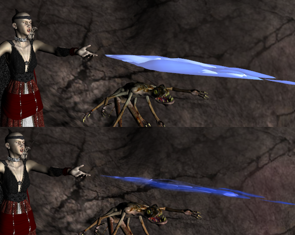

    edited May 2013
    Studio Version 4.5.2.40

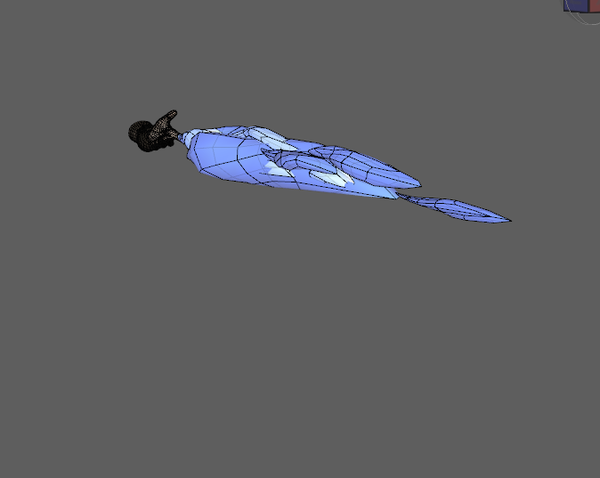

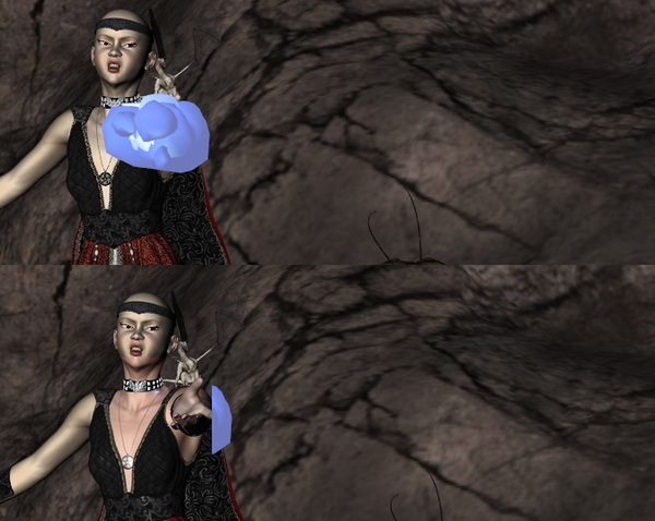

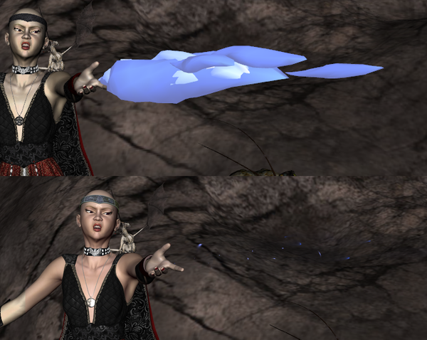

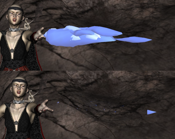

    Here are screens of how it looks in scene and how it looks in render.
    In each picture, the top half is in the scene editor and the bottom half is spot-rendered (full renders are identical in the rendered areas).
    As you can see in 'a', the flames render fairly well, but in the other three positions, you can see that the closer you get to a head-on shot, the less it produces.
    I have also included a Wireframe shot so you can see the makeup of the flame.
    674 x 537 - 34K
    674 x 537 - 442K
    674 x 537 - 438K
    674 x 537 - 418K
    674 x 537 - 440K

  • Richard HaseltineRichard Haseltine Posts: 111,093
    Clutching at straws, but try turning up ray trace depth.
    I ran it at 5, 10, and 16. No difference.
    edited May 2013

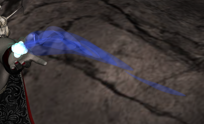

    Inner and Outer Colour on the surface tab controls the transparency of the shader. When you are viewing the props from such an angle that they start to disappear like that then you need to adjust the inner or outer colours to compensate. Also, lighting will effect how these look.
    Post edited by Mattymanx on
    edited May 2013
    That did it!
    Thanks Mattymanx!
    That was just the tweak it needed. I bumped the Outer Colors by just a bit and got just the effect I was looking for.
    I never realized what those were for. Thanks again for the tip!
    EDIT:
    This is what I was aiming for...
