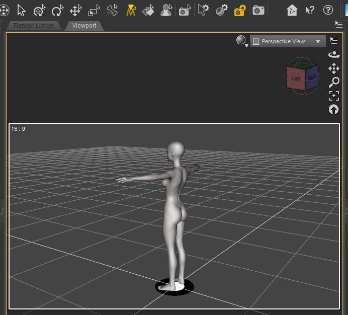

    If you are using an aniblock which is repositioning your figure, you just need to click on the "animate2 Tool" icon, (it looks like an M with a triangle over it) that will create a round disc under your character. You can then drag that disc with your mouse to reposition the character for the aniblock.
    692 x 626 - 60K

  • IvyIvy Posts: 7,165
    edited December 2017
    This is what I would do too
