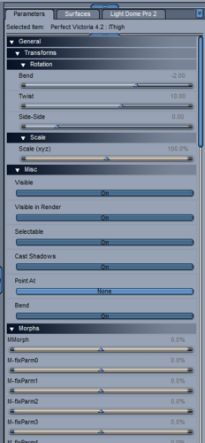

    Something is not right with your Perfect V4 here is my lThigh in Parameters, it has 100 fixes.

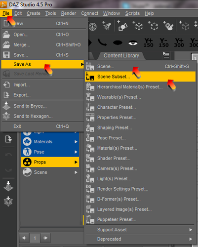

    No. I'm saying Inject all the needed morphs into the Perfect V4, shape your character with all the morphs, add the texture you wish to use then in DS do File>Save As>Scene or in DS4.5 File>Save As>Scene Subset
    File Menu>Save As selected option>Scene enter a Name and save to a Default DS folder. I use V4 Characters. That saves it just the way it was when you saved. It makes a Icon in the folder you Have open in Content that you then can Load (double click) or Merge (Right Click on Icon) at anytime.

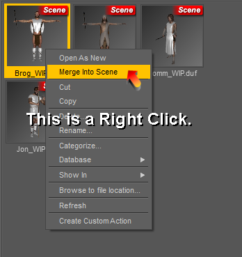

    Here is one of my Character Folders, a double click loads what you see on the Icon into my empty scene. Or as shown a right click opens a menu that offers the Merge option.
