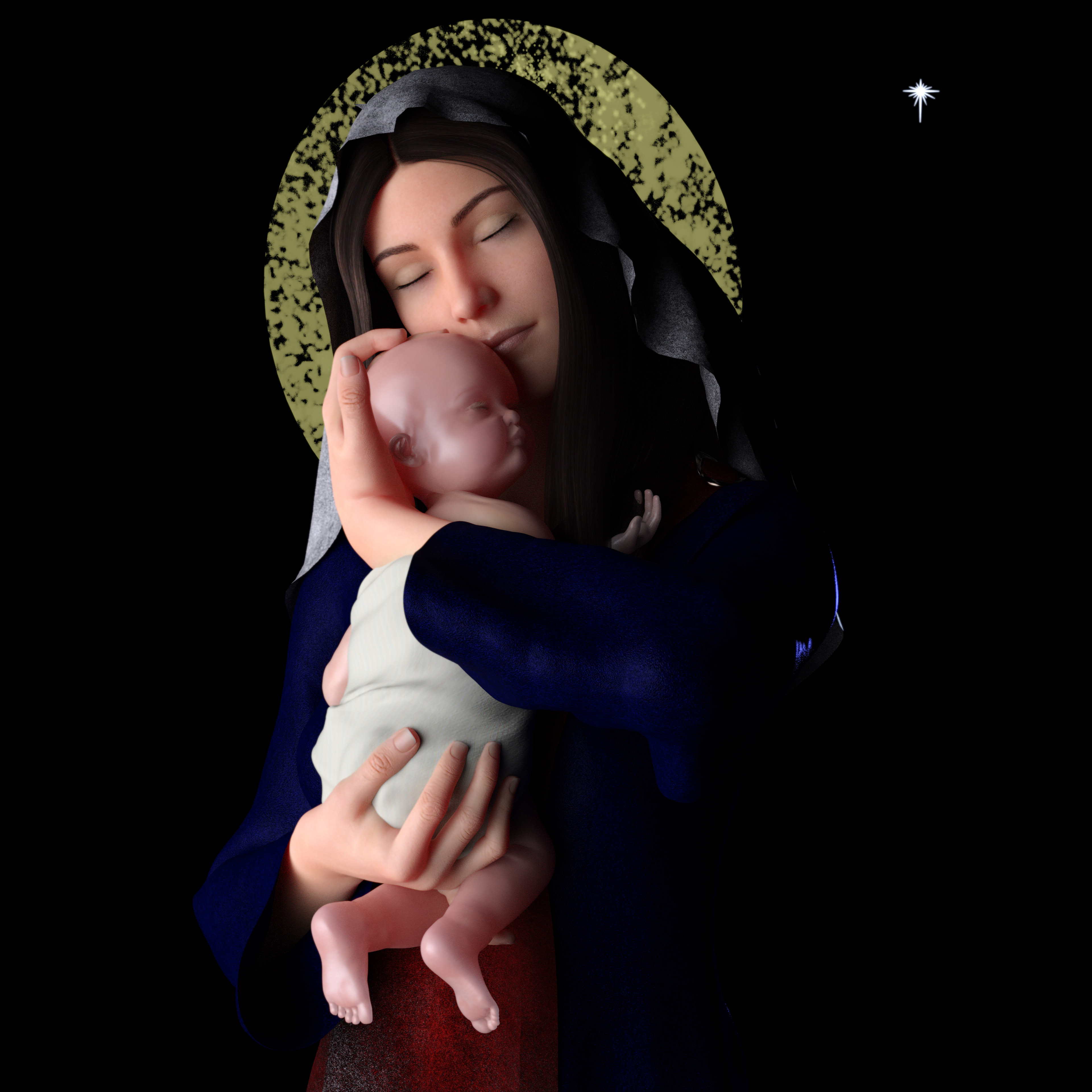

    OK, I have attached the render to 77% to show what I mean. I also attached a screen shot of the viewport with the 'halo' light that I am trying to use to make that rim light 'halo' effect like portrait studio do. I have it set to point at a DAZ primitive cylinder that is only about 2mm long and has a transparency cutout supplied (actually a frost shader via a preset for the 'Let It Snow' product in the DAZ Store).
    Also, when I use the dForce on the dress she is wearing for some reason the right sleeve (the one that is supporting the baby's head) instead of falling down to the floor is falling away from the baby even though I made the baby and it's blanket invisible in the viewport / scene (but not with the Visible in Render button on the dForce settings).
    No halo rim light. I want to make a glow around the halo & head & shoulder area of the mother and child.
    In an effort to make the halo glow I did set it up as an emmisive light with crazy power (100K) and 2000K temperature & the light colors pale yellow. That emissive cylinder is between the halo disk light & the mother & child.
    3840 x 3840 - 6M

  • Ah, you want translucency (or possibly to make the surface emissive).
    You've made the baby not Visible in Simulation?
    Yes, the baby & blanket were made invisible in the viewport but not the simiulation settings. I will simulate again with the baby & blanket invisible also in the simulation settings too.
    The 'emssion' on the cylinder wasn't being 'glowy' unless I used bloom filter so I turned it off and am only use disk photometric light for the rim now.
    edited December 2017
    Well I've got a vague analogy to halo lighting after dorking around with light settings, positions, and stuff so I will be done with it for now. Basically I had to create 'fake atmospheric haze' for the light to scatter in. I had hoped for something much less compute intensive.

    Try turning on Bloom in the render settings.
    Yes, thanks.
    I have done that but it's difficult to find a bloom setting when CPU rendering that is not too much bloom (subjectively) but I did find one I think is not too much. SickleYield also has a turorial for creating GodRays so I adapted that to create atmospheric dust effect so that the bloom is more obvious. Those do make the render go much slower though, however I wanted to learn techniques that don't involve postprocessing.
